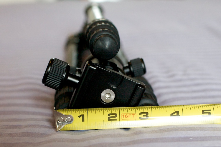

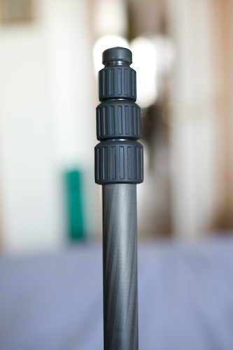

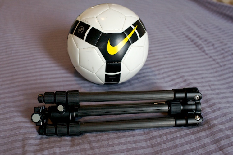

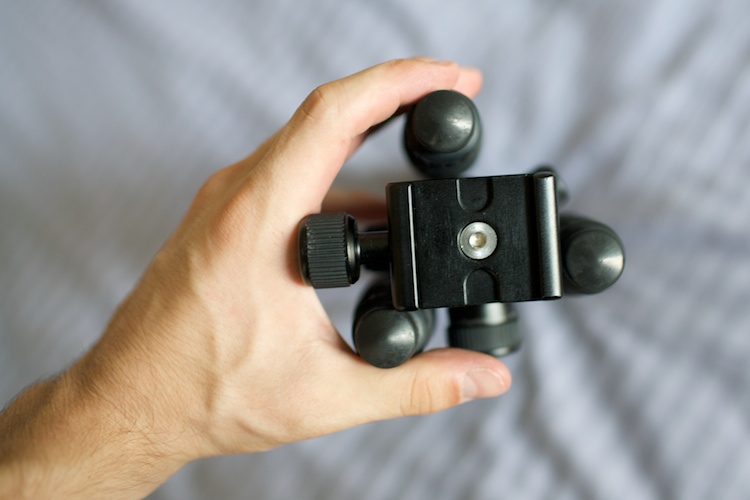

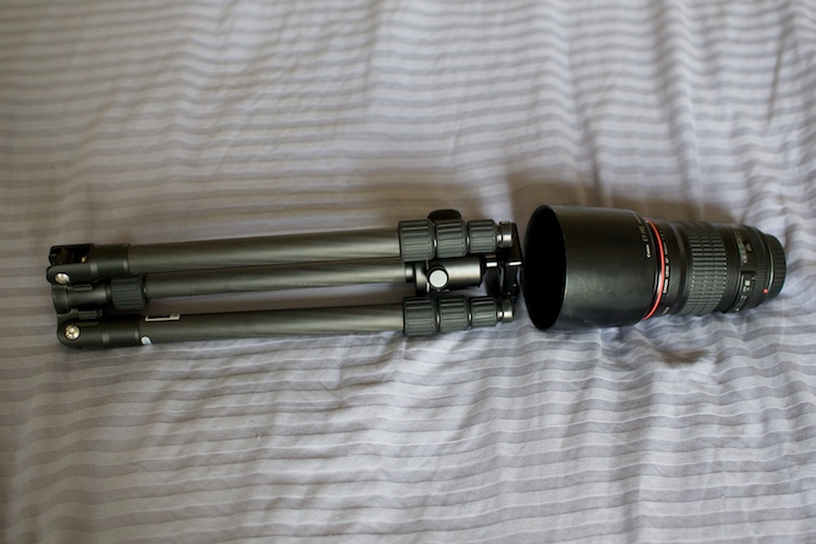

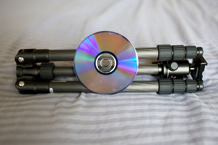

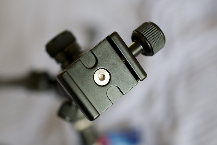

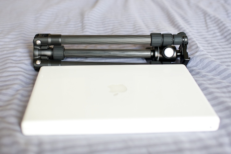

Specs w/ ballhead:
Folded length – 14”
Weight – 1.96 lbs/0.8 kg*

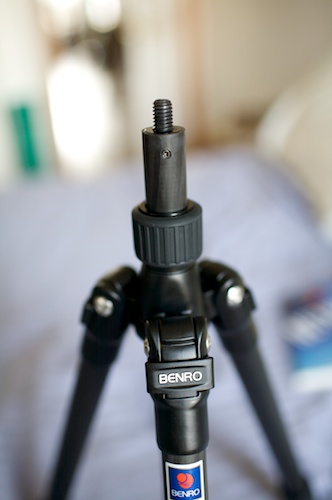

* According to a Benro Marketing Manager, there are two versions of this tripod, and the one sold in the kit has a lighter center column. I think that the difference is that the “kit” version comes without a real mounting plate to reduce weight and column height, and to allow the legs to fold tight. The weight reduction to the “kit” legs because of this is ~ 0.2 kg. Mine lacks a true mounting plate. As far as I can tell, this only applies to the 0-series legs.
IMAGE: http://photos.russjuskalian.com/2009/07/25/5.jpg
Max Height – 45” to top of QR, 49” to viewfinder (5D)
Max Height w/ Column – 53” to top of QR, 57” to viewfinder (5D)
Min Height – 14”
Max Cross Section folded – Hard to determine, but 3” to 4” depending how you measure.
Leg Diameter – 22mm (biggest)/13mm (smallest)
Leg Sections – 4; top 3 non-rotating, bottom rotating.
IMAGE: http://photos.russjuskalian.com/2009/07/25/6.jpg
IMAGE: http://photos.russjuskalian.com/2009/07/25/7.jpg

Background on what I was after:
My goal was to find an ultra-light, ultra-compact tripod for extended travel through sometimes dangerous locations where I can’t be encumbered by heavy, bulky gear. Dead stability and full height were not the driving forces here, though maximizing both within the constraints of size, weight, and ease of use were obviously important. I didn’t want to be stuck with a true table-top tripod or ground pod. Money was not a primary factor here, nor was trying to find an all-around perfect tripod. I was after a niche product.
Why I chose a Benro instead of a Gitzo or Feisol:
I was considering three other tripods: Gitzo 1550t, Gitzo 1541t, and Feisol 3441s. All three have advantages over the Benro combination I purchased, though at the same time couldn’t match the Benro specs I was after. This search was initiated via the Gitzo 0-series tripods (0531/0541), though without having a 0-series that folds over the center column, the folded length was too long for my needs.
The 1550t is light enough (when used with its insufficient, included ballhead), and folds compact enough—but has 5 legs when I wanted 4 max. (I also wasn’t interested in the ballhead that came with it, and third party heads would compromise the weight/compactness of this tripod.)
The 1541t has 4 leg sections, but only folds to 16 inches, and weighs 2.1 lbs without a ballhead. Advantages: This leg set is probably more stable than the Benro.
The Feisol 3441s has 4 leg sections too, but only folds to 17 inches, weighs 2.2 lbs without a ballhead, and has rotating legs. A shorter center column would bring the weight down, but wouldn’t change the folded size. That and the rotating legs killed it for me. Advantages: This legset, with a 28mm largest leg diameter, is probably more stable then both the Benro and the 1-series Gitzo traveler, and reaches higher.
Only the Benro could get me in at ~2 to 2.2 lbs with a ballhead, fold down to 14 inches, and do it all with 4 leg sections that don’t rotate (the last leg rotating doesn’t have any impact on use; see below). As long as the Benro was up to the task—and stable enough for the lenses I wanted to use—the specs would be the deciding factor. Neither Gitzo, nor Feisol, nor Induro or any other manufacturer that I felt comfortable with made a tripod with comparable specs. It Gitzo makes a 0-series Traveler design, I’ll reconsider.

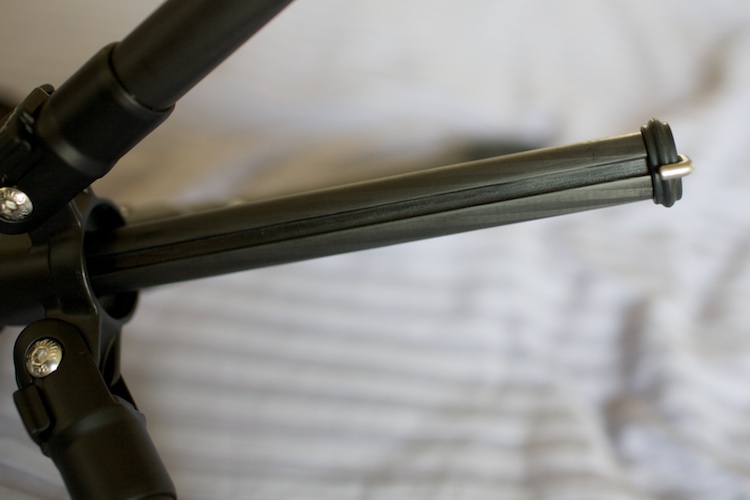

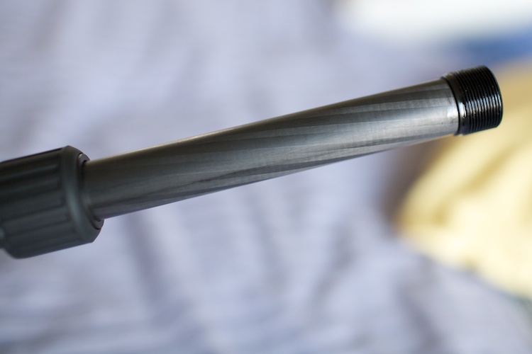

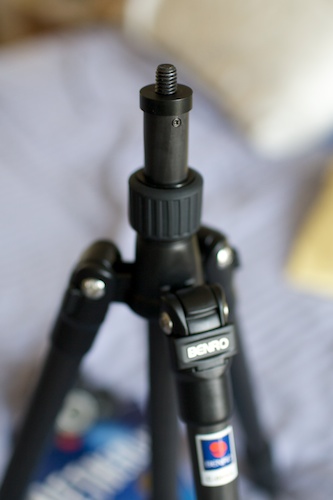

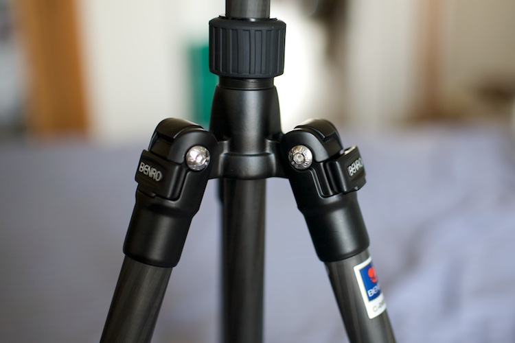

Construction:

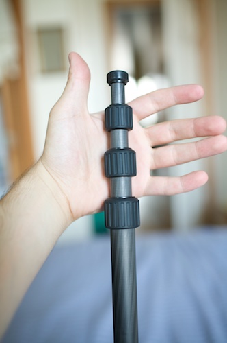

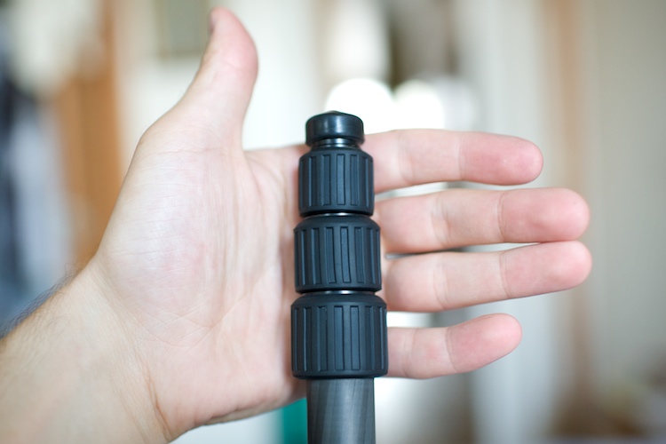

Side-by-side with comparable Gitzo legs, the Benro feels up to par. The bolts that the legs rotate on were a little too stiff for me when I bought the legs, so I used the included tool to loosen them the tiniest bit; the tighter setup is probably a hair more stable.
The leg sections are stiff when locked, and lock tight. Unlike some of the other inexpensive brands, Benro has a tiny set screw (see photo) that holds the center column bolt mechanism down tight. The center column uses the same construction to secure the screw mechanism at the bottom of the center column for the spring-loaded weight hook. The center column is grooved so that it does not rotate. The rubber, bottom feet unscrew and can be replaced with pointed, metal feet. All the moving parts that need it are well-greased, and fit TIGHTLY together. The fit is very precise, the cutting/molding is very clean (any mess you see is just grease).
IMAGE: http://photos.russjuskalian.com/2009/07/25/4.jpg
IMAGE: http://photos.russjuskalian.com/2009/07/25/8.jpg
IMAGE: http://photos.russjuskalian.com/2009/07/25/9.jpg
IMAGE: http://photos.russjuskalian.com/2009/07/25/10.jpg
IMAGE: http://photos.russjuskalian.com/2009/07/25/11.jpg
IMAGE: http://photos.russjuskalian.com/2009/07/25/12.jpg
[URL][URL]http://photo​s.russjuskalian.com/20​09/07/25/15.jpg

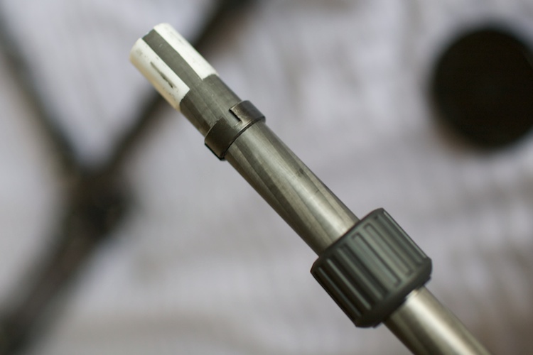

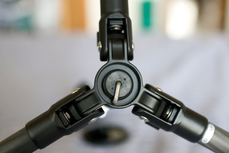

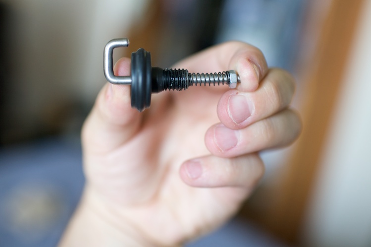

As you can see, the legs use a similar anti-rotation lock mechanism to found in Gitzo and other brands. It’s actually just a sleeve of some kind of white, plastic-like material. The black, locking ring looks very similar to the Gitzo gravity lock, though I think it functions differently.
IMAGE: http://photos.russjuskalian.com/2009/07/25/16.jpg
IMAGE: http://photos.russjusk​alian.com/2009/07/25/1​7.jpg

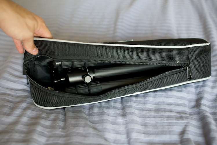

The set came with a simple tool to tighten/loosen the bolts, and a very nice bag with a shoulder strap. The bag is well constructed, has a small internal pocket, and can easily fit the tripod with a larger, taller head.

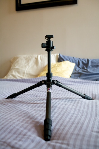

Use:
The tripod is a pleasure to use. The legs slide in and out very smoothly/easily, and with one short throw of the locks (1/4 twist), all the leg sections can be unlocked at once due to the anti-rotation locks. That the last leg section rotates does not matter because there obviously isn’t any sort of twist lock on it. Pulling on the shortest leg with a smooth tug extends the whole leg. Once the legs sections are retuned to the closed position, all of the leg locks can be similarly locked with another short throw.
IMAGE: http://photos.russjuskalian.com/2009/07/25/13.jpg
IMAGE: http://photos.russjuskalian.com/2009/07/25/14.jpg

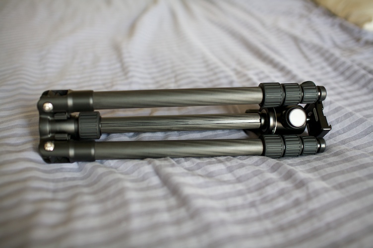

The legs can fold over the ballhead and center column to fold this tripod down to a compact size. It’s rather incredible.
The legs are very stable for use with wide to short-telephoto lenses, but the difference in stability between being put in low-angle positions with only one or two legs extended vs. the tall position with all legs extended is definitely noticeable when the camera is mounted and I try to manually induce vibrations into the system. At lower positions and less than full leg extension, the tripod is VERY stable with 5D and 135L.

I’m not a huge fan of the rubber grip/locking mechanism on the center column. I would prefer a solid, molded “knock-off” wheel style locking mechanism—but I assume the rubber leg-lock style is used to keep the weight down.
Unfortunately, there is no stock way to do something like the ground-set on a Gitzo. You can remove the center column and flip it upside down, though it’s a bit of a pain to do this. That said, the 14” minimum height limit is fine for me.
One thing I noticed myself doing is not fully tightening the center column at times. This is stupid for a couple reasons, but I found myself doing it because the center column takes a decent amount of resistance to slide up and down—and the groove in it that prevents it from turning gives the false impression that the column is locked. It’s not a big problem with the column down (which is how I mostly shoot), but the whole system is more stable when the column is locked down securely.
This tripod is LIGHT, and folds down super compactly. I can throw it inside (!) a regular backpack with some cloths and two lenses and not notice I even have it in there. I don’t hesitate to take it with me.

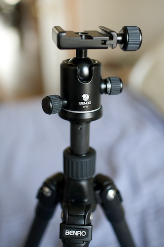

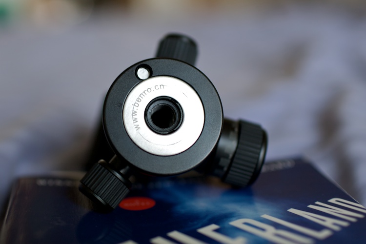

Ballhead:
These legs usually come with the B-00 ballhead, but having heard that the standard ballhead is the weakest link in the system for these legs, I found a seller who had (or made) a package with the larger, B-0 ballhead. It’s possible that my legs would close ever so slightly tighter with a smaller ballhead, but I don’t think the difference would be noticeable without a close measurement; it surely wouldn’t make any difference in packing or use.
IMAGE: http://photos.russjuskalian.com/2009/07/25/18.jpg
IMAGE: http://photos.russjuskalian.com/2009/07/25/19.jpg
IMAGE: http://photos.russjuskalian.com/2009/07/25/20.jpg
Not much to complain about this head. It’s super smooth, locks down tight, with no slip/creep in the panning lock or ball. Could it lock tighter? Maybe. I didn’t want to test what the failure point was. I’d like to try the smallest Photo Clam, which weighs the same as this ballhead. The QR takes AS plates, and locks down securely and easily. Given my use for this ballhead, I find the friction knob superfluous (another reason to go with the Photo Clam), but the panning knob quite useful and well made.
The head is not ideal for the 135L + 5D combination at a steep angle. Does it work? Yes. Do I have to be careful, use MLU, and lock it down tight? Yes. With my other lenses: Peleng 8mm, Oly 24mm, 35mm L, FL 55 f/1.2, any angle locks down securely and easily.
Given the online breakdown of an older, different model ballhead from Benro, I do wonder what the internal construction of this ballhead consists of. I hope to break this one down at some point—but not until I have a replacement (Photo Clam PC-30N).

Jul 29, 2009 00:42 |  #11
Great review! I recently bought the C068-M8 legs only from BHPhoto, but the fold seems different than yours. On mine, the center column seems longer and head platform is even with the legs when reverse folded. (See below for a photo of my tripod folded.) I guess the kit version comes with a shorter center column besides the platform difference? Strange.

Aug 02, 2009 20:40 |  #14
justrussfm wrote in post #8387206 (external link)
This is one area it would make sense if Benro would point out the difference more clearly. I didn't know about this until I bought the legs.
Yeah, I wish they were more clear on this too. I didn't know the differences until after I bought as well.

Glad I found this thread. I have been wondering why my center column is different than all the pictures I have seen for this tripod and now I know. I use a Markins Q3T on mine and would love to have it fold just that little bit shorter.
Anyone know if the shorter center column is available for sale by itself anywhere?
