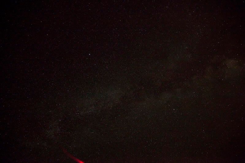

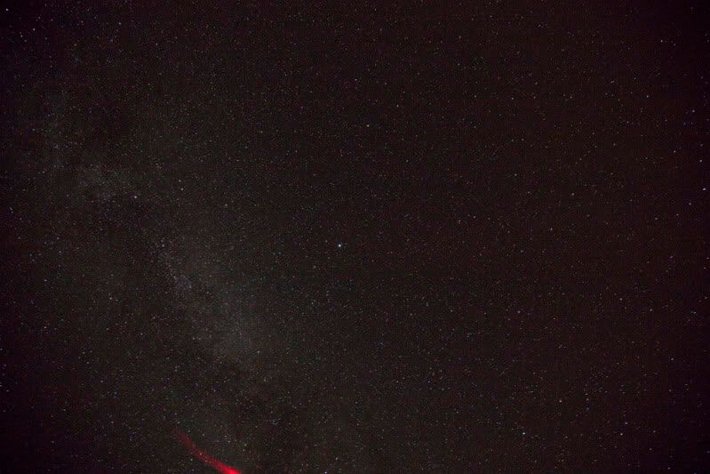

OK so i was out shooting the stars last night, hoping to get a few meteors. Well instead i got some weird red streak on the bottom of my shots. I have no idea what it is, or where its from. Here are the specs from last nights shots. I used my 24-105L, i took a couple shots at full zoom and the red streak is not there. They only show up when im zoomed out to 24mm. I also know it was not a red light from anywhere near me because i took different shots that were pointing in different directions. Im completely stumped by this, because its not in any normal shots (ones that are not long exposures). So any help would be great. I also have a uv filter on the lens. Also, the sensor was cleaned beforehand so i know it wasnt dirty.
IMAGE: http://i110.photobucket.com/albums/n106/tsrslogtp03/Photography/Stars02_small.jpg
IMAGE: http://i110.photobucket.com/albums/n106/tsrslogtp03/Photography/Stars01_small.jpg

Even though your camera angle and subject has changed, the object is in exactly the same place. I am guessing it is a hair, illuminated by a LED inside or outside the camera.
Alternatively, could it be a crack in your lens or even in the CMOS chip or filter glass, again lit by a LED somewhere?

now that i take a closer look, there is a tiny tiny almost like a bubble in my filter. il take it off, and do another couple tries tonight to see what happens.

I was going to suggest taking the filter off and retesting.

Update: It was the crappy Canon uv filter i had on there. I usually take it off when shooting at night, but i forgot. Took some new shots last night and i will post them later after i edit. Thanks for the nice compliment on the photo. Thanks again for the help guys.
