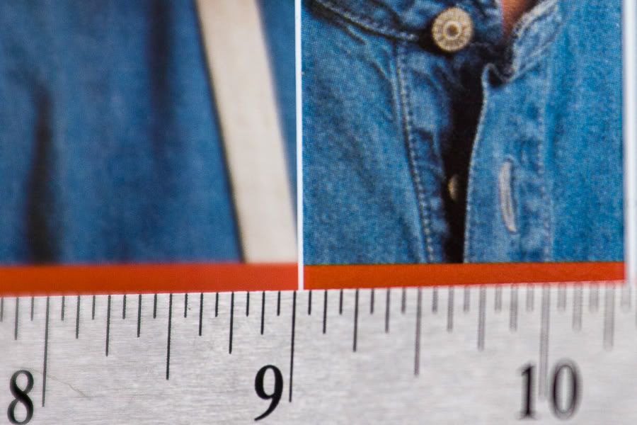

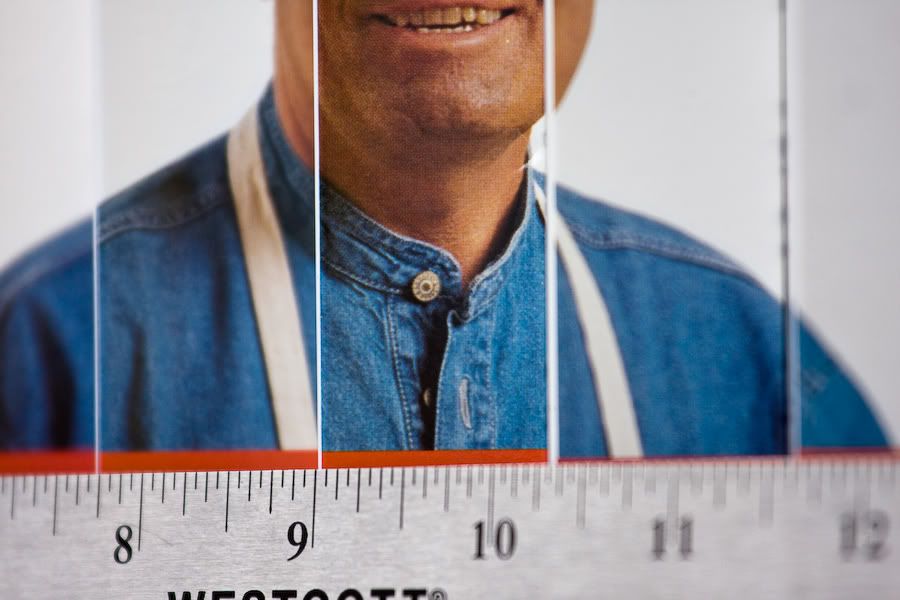

Here is the test at 200mm, MFD. VCR boxes staggered at 2cm increments. Focus plane in the center where the 9" mark on the ruler is. First the full frame resized for POTN
IMAGE: http://i69.photobucket.com/albums/i63/wiltonw/Focustestfullsize-1.jpg
Now 50% of the frame...
IMAGE: http://i69.photobucket.com/albums/i63/wiltonw/Focustest50-1.jpg
