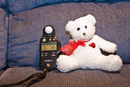

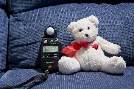

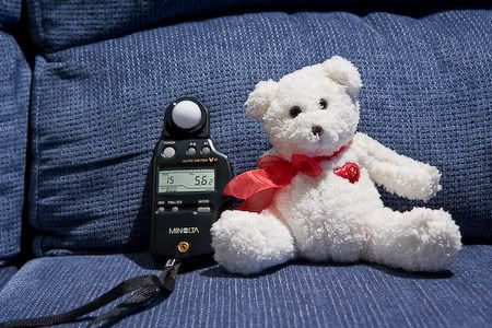

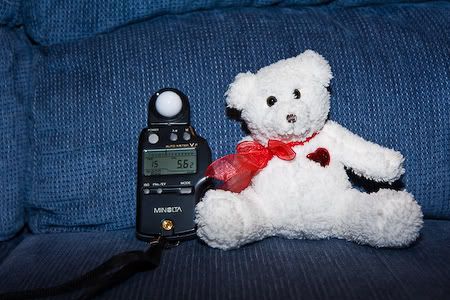

Here is a sequence of shots that I took to illustrate what happens without flash and with ETTL flash, in M and Av and Tv and P mode. All shots assume ISO800. Ambient lighting was halogen track lighting in my family room. Blue text indicates photographer controlled parameter; black text indicates camera-selected parameter. Note that the incident meter indicates the combination of f/stop and shutter speed (1/15 f/5.6 +0.2EV) for the light striking the scene, while the camera's own Spot meter saw the area between the meter and the stuffed toy and read the exposure to be a bit darker, so it chose 1/15 f/4.5 as the needed exposure.
In sequence A, no flash:
M 1/15 f/4.5
Av 1/15 f/4.5
Tv 1/15 f/4.5
P 1/40 f/2.8
The results are identical although the camera chose the different shutter speed and f/stop when in P mode. ( I altered WB in post processing the eliminate the excessive warmth of halogen lighting while the as-shot camera was set to Daylight WB.)
IMAGE: http://i69.photobucket.com/albums/i63/wiltonw/IMG_2548.jpg
IMAGE: http://i69.photobucket.com/albums/i63/wiltonw/IMG_2549.jpg
IMAGE: http://i69.photobucket.com/albums/i63/wiltonw/IMG_2550.jpg
IMAGE: http://i69.photobucket.com/albums/i63/wiltonw/IMG_2551.jpg
In sequence B, with ETTL flash:
M 1/15 f/4.5
Av 1/15 f/4.5
Tv 1/15 f/4.5
P 1/40 f/2.8
(I had daylight WB in the as-shot camera due to usage of flash.)
IMAGE: http://i69.photobucket.com/albums/i63/wiltonw/IMG_2552.jpg
IMAGE: http://i69.photobucket.com/albums/i63/wiltonw/IMG_2553.jpg
IMAGE: http://i69.photobucket.com/albums/i63/wiltonw/IMG_2554.jpg
IMAGE: http://i69.photobucket.com/albums/i63/wiltonw/IMG_2555.jpg
Note that I had CFn set so that camera uses 1/250 when flash is used in Av, regardless of ambient conditions. Had that CFn been set to the factory default, it would have seen that I had set f/4.5 and it would have chosen 1/15 shutter speed to suit, to capture the ambient light while using flash.
In the second series, because the WB was set for flash, but the ambient was 50% of the exposure so the halogen lighting 'contaminated' the light in the shot made in M and TV and P modes. In Av, because 1/250 was the camera-selected shutter speed, the halogen light did not conataminate the light provided by the flash. Also, because FEC = 0 and because the ambient light alone provided sufficient exposure, the addition of flash actually resulted in overexposure (light is like water...add too much and it overflows!) The P mode shot in the second series had less contamination than M or Tv did, because the camera set 1/60 (-2EV exposure) but increased the f/stop by only 0.5EV, thereby reducing the amount of light contributed by the halogen ambient lighting.
