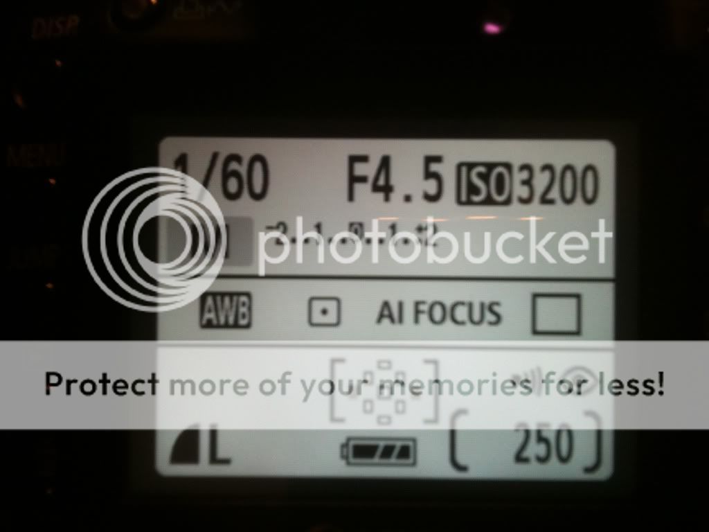

Jan 16, 2010 19:13 |  #506
IMAGE: http://i338.photobucket.com/albums/n427/apinechevy/314c116b.jpg
got it guys that you so much !!!!!
