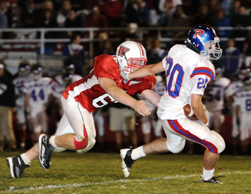

1) Coming right at me ... had to lower exposure in DPP about 1.5 stops
IMAGE: http://i14.photobucket.com/albums/a310/dsnyder160/DPP_13243TIF.jpg

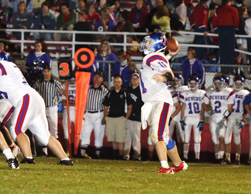

2) Good example of 1/320 not fast enough or, is there a way to compensate for this?
IMAGE: http://i14.photobucket.com/albums/a310/dsnyder160/DPP_13241TIF.jpg

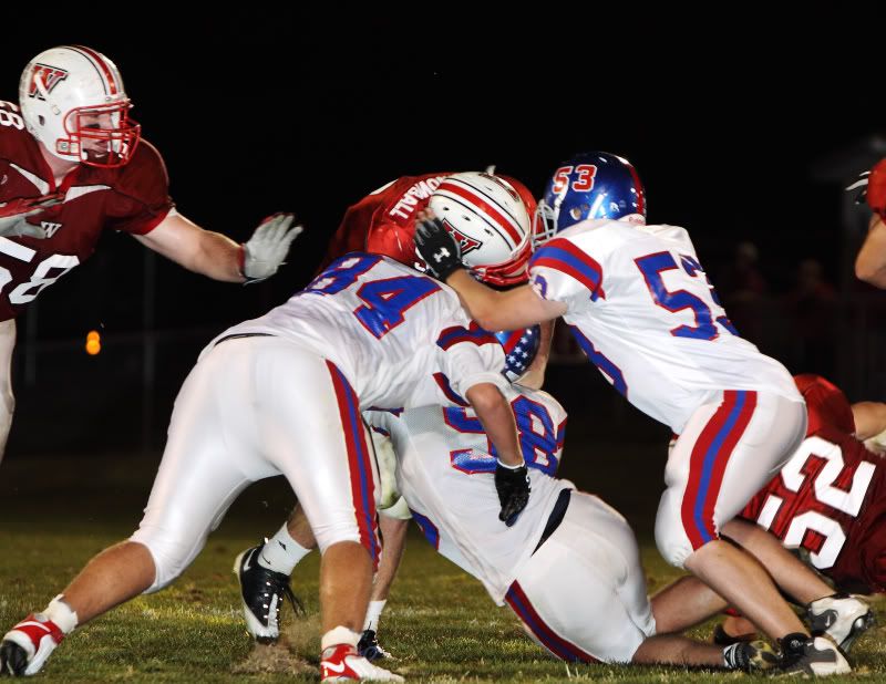

3) This was the best of the flashed shot. The play was actually going the other way when the running back decided to do a 180. Was still caught for about a 10 yard loss on the play
IMAGE: http://i14.photobucket.com/albums/a310/dsnyder160/DPP_13238TIF.jpg

I don't know the max sync speed for the 50 D (I suspect it is 1/250) but you want to be sure not to go faster than that speed. The "stopping" ability of a flashed image is a function of the flashed light being well above the ambient level. Dennis has a itunes podcast on the subject. Stay shooting manual at the max sync speed for your camera. Shooting faster than max sync gets you into HSS and as a general rule, you don't want to be there.
What mode is your flash in? Manual or ETTL? Both settings are used but we will need that info to talk you through it. Personally, I use ETTL at +1, ISO 800, f/4.0 for many of my shots. Those settings can be tweaked up or down depending on the results you get.

Dave when you are using flash shutter speed has little to do with stopping the action. Well it does to a certain extent but the flash output can always be raised to over come it.
If you look at this thread I posted yesterday https://photography-on-the.net/forum/showthre​ad.php?t=755566 you can see at even 1/60s and 1/80s with the proper balance of flash over ambient the motion can be stopped. These riders were about 2-3 feet away going 25+ MPH. You notice also as the light disipates across the subject you start to get ambient bleeding through and the motion blur.
