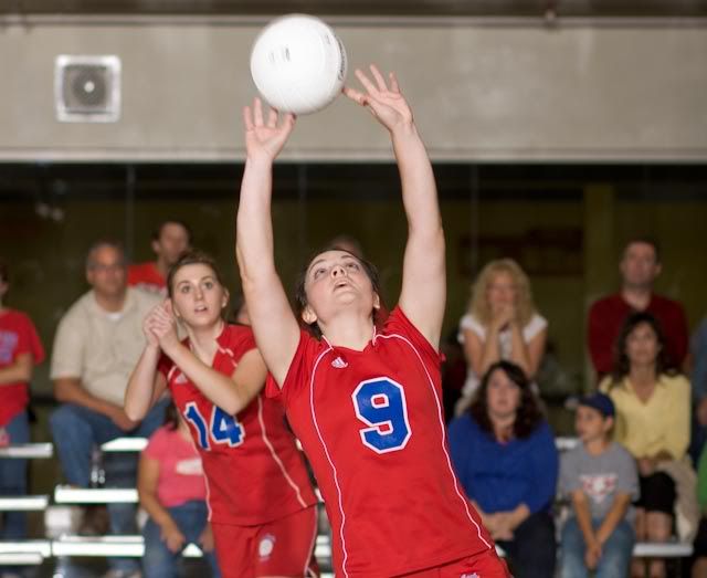

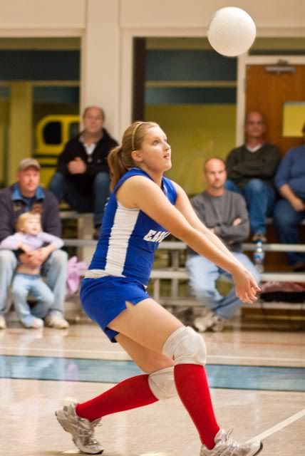

I've recently started shooting the local high school volleyball team using a strobe and while I like the direction the IQ of the pictures are taking, there's still some shadowing I'd like to eliminate. Hopefully some of you have some tips.
Right now I'm using one 350 WS strobe because I can only afford one at this time -- I've been using it at full power with the reflector base attached.
1:
IMAGE: http://i833.photobucket.com/albums/zz253/tjketa/IMG_6290.jpg
2:
IMAGE: http://i833.photobucket.com/albums/zz253/tjketa/IMG_6249.jpg
3:
IMAGE: http://i833.photobucket.com/albums/zz253/tjketa/IMG_6238.jpg
The strobe is mounted on a running track above the gym floor aimed straight across the other side at the center of the court. Would lessening the flash power help maybe?
Thanks in advance -- Tom

Sep 27, 2009 01:46 |  #2
Tom,
You do not want to lower the power of the strobe. More is better. Strobes are effective when you can get close to 3 stops over ambient light levels. It appears that you are shooting your one strobe direct, ie not bounced off the ceiling or wall. That will cause shadows. Not being 3 stops (or close) above ambient will also result in 'ghosting.' Unfortunately, it will probably take a second strobe to get past those problems.
If you do get a second strobe, then you will have the choice of flashing directly toward the players or bouncing off the ceiling. Direct flash tends to have slight shadows but gives a stronger light hitting the players. Bounced gives a soft light without shadows but it takes more lighting power. My preference is bounced light but both are used successfully and it is just personal preference.

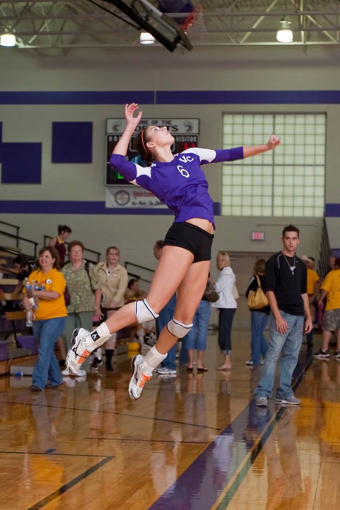

Here are some recent volleyball shots using multiple strobes bounced off the ceiling.

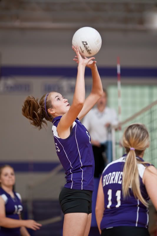

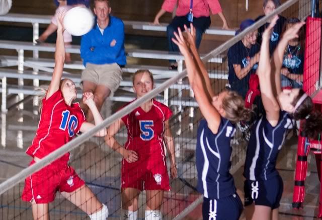

Thanks again for all of the great feedback. I went out and bought a simlar strobe to what I currently had, pointed them both to the ceiling tonight and this is what I got:
1:
IMAGE: http://i833.photobucket.com/albums/zz253/tjketa/IMG_6564.jpg
2
IMAGE: http://i833.photobucket.com/albums/zz253/tjketa/IMG_6575.jpg
I'm very pleased with how they look now and just need to make little tweaks now.

Sep 28, 2009 21:11 |  #11
Lighting looks great! The first shot looks pretty out of focus though.
