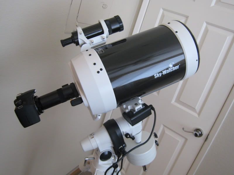

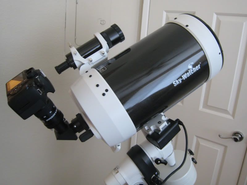

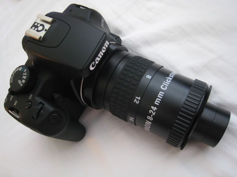

Here is the setup i'm using:
*Skywatcher 8" SCT
*Tele-extender or Hyperion Eyepiece adaptor
*Canon T1i (upgraded from the XSi in the photos)
IMAGE: http://i579.photobucket.com/albums/ss236/ForumRiderUSA/Telescope%20Photos/1.jpg
IMAGE: http://i579.photobucket.com/albums/ss236/ForumRiderUSA/Telescope%20Photos/2.jpg
IMAGE: http://i579.photobucket.com/albums/ss236/ForumRiderUSA/Telescope%20Photos/3.jpg
IMAGE: http://i579.photobucket.com/albums/ss236/ForumRiderUSA/Telescope%20Photos/Setup.jpg

Oh man that's gonna be a really tough setup to learn on, 2000+mm focal length and you're using an eyepiece? Yikes.
Might be a good idea to find a focal reducer to bring that 2000mm down to 1250m or so, and then image at prime focus, rather than using the eyepiece. It'll still be really tough tho.
The other option is go pick up a cheap 80mm refractor, take pictures through that, and hook up an autoguider camera to the SCT to steady the whole thing via guiding (assuming that mount has an ST-4 autoguiding port on it). SCT is great for planets im sure, but for just starting out with deep sky stuff you're in for quite a battle I suspect.
