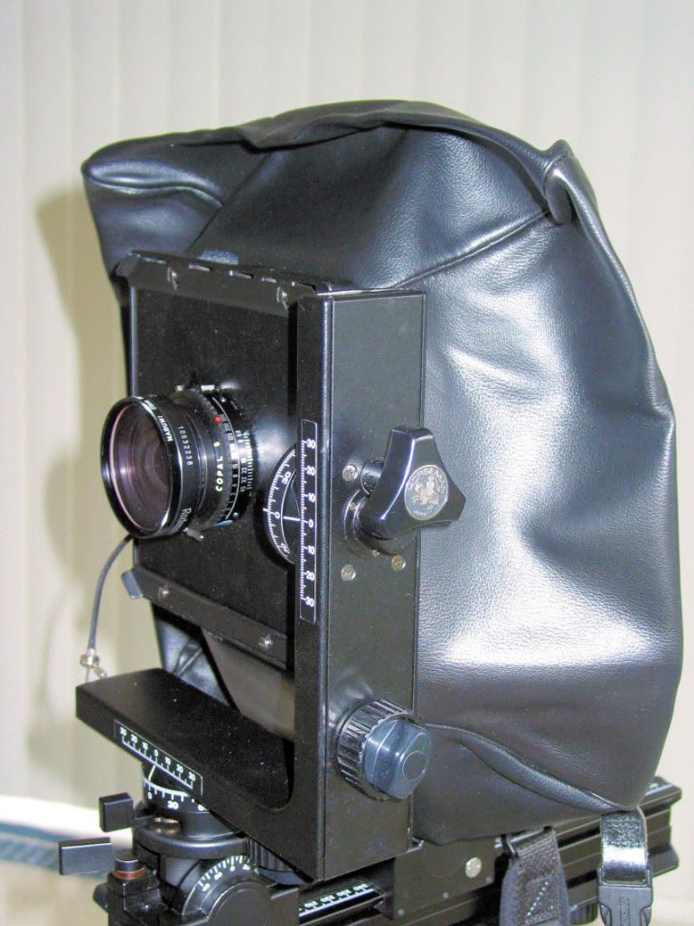

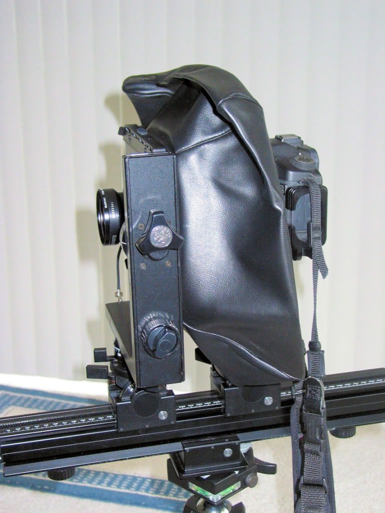

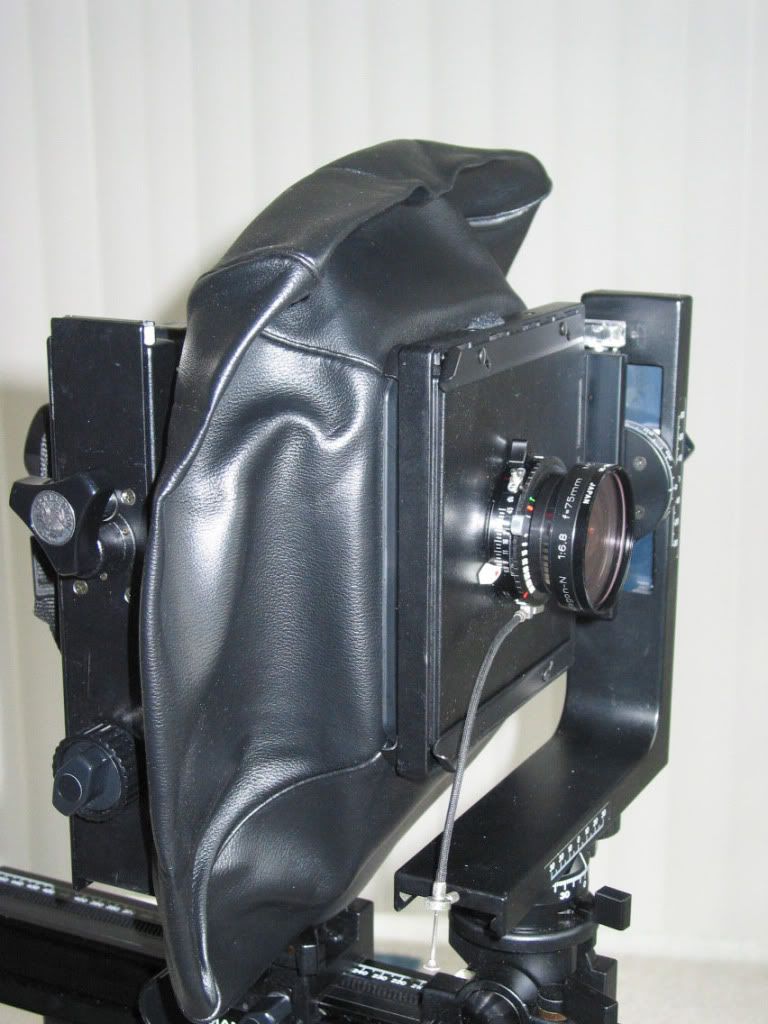

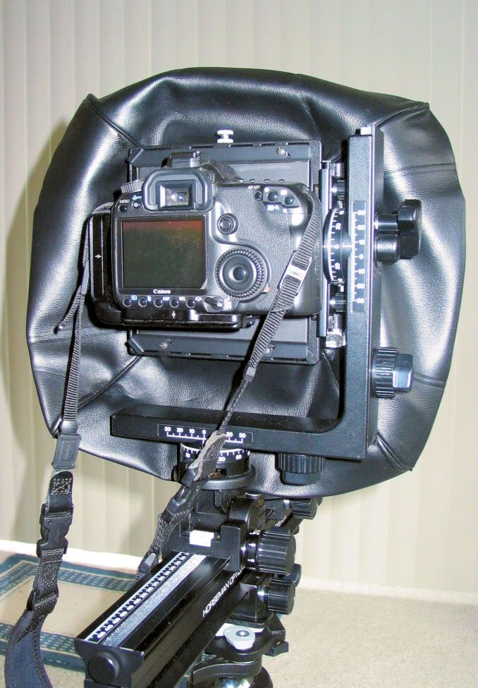

I just completed the task of mounting an adapter to an extra lens board, so that my 40D could be mounted onto my Horseman large format monorail camera. I thought I'd share the results in this thread.
IMAGE: http://i69.photobucket.com/albums/i63/wiltonw/Equipment/IMG_2970s.jpg
IMAGE: http://i69.photobucket.com/albums/i63/wiltonw/Equipment/IMG_2969s.jpg
IMAGE: http://i69.photobucket.com/albums/i63/wiltonw/Equipment/IMG_2966s.jpg
IMAGE: http://i69.photobucket.com/albums/i63/wiltonw/Equipment/IMG_2968s.jpg

Looks like a great project, I may try and rig my Cambo to do the same.

Having used both tilt-shift lenses and several kinds of view cameras, a tilt-shift really only gives you a taste of the capabilities of view cameras, especially monorails. The degree of independence and precision of all the tilt, swing, shift, rise, and fall movements on a view camera can never be replicated on a tilt-shift lens.
The biggest problem with this setup is that it's basically impossible to do wide angle work -- you're just not going to find a wide enough lens that has enough coverage for movements. Well, unless you're using the 17mm TS-E as your lens on this setup.
The widest medium format lens that I'm aware of is the 38mm Biogon that's used on the Hasselblad SWC. That's extremely wide for MF, and it will have a big enough image circle to give movements on a small format sensor, but it's just not all that wide.
And small format lenses don't cast a wide enough image circle for movements (if you're at infinity focus -- if you are focusing closely then the lens will be farther away from the camera so the image circle will project larger).
You could stitch to achieve a wider angle, but if your subject is architectural (with a lot of geometry) then you get into parallax problems.
But for standard angle stuff, like moderately distant subjects, you could get a TON of movement.
I've got a Schneider 90mm XL lens with a ridiculously large image circle. The amount of shifting could be huge (when I think about cutting out a small format size part of the edge of a fully shifted 4x5 image with that lens).
Add the limitation that, even with a lens board which is recessed, the rear elements of the LF lens will protrude and likely even hit the rear lens board even if the standards can be moved close enough together (which mine do). For example, my 75mm large format lens hits the rear lens board even without being mounted on a recessed lens board. So 90mm is the minimum FL, unless I try to find and adapt a suitable medium format lens of shorter FL, which does not have elements to stick out behind the lens board. And even with the terrifically expensive 38mm, that isn't wide angle by any measure on APS-C and is scarcely WA even with FF camera mounted. We're talking product shots and macro work for this kind of a setup.
