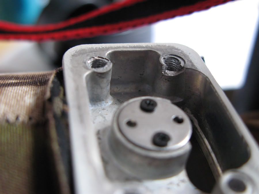

I was out shooting today with the 500mm on a monopod. Suddenly it dropped at the front and the foot was hinged. What has happened is that 2 of the screws have popped out. The result is this

and here I have highlighted all the cracks

Looking at the first shot it looks like the thread has been stripped in top right as though it has been cross threaded at some stage.

Its pretty obvious from the shots that thats cast aluninum. That's dissapointing to see that from Canon as much as those lenses cost. I had hoped they would have made that out of a forged block of material and CNC machined with Heli-Coil inserts (high tensile steel thread inserts) to beef up the threads, but that's just me. I tend to be a little more critical over failures like this since I work for a company whose clients include Boeing, Raytheon and the U.S. Navy so I get spoiled being around the 1st class stuff.

When I look at the available bearing surface and the fact that the interface is, for the most part, subject to static loads, I would expect this design to be sufficient unless the lens is subjected to a severe bump exposing the foot to shear loads.
Perhaps it was a faulty casting - voids, or thin walls on the threaded bosses, or undersized tapped holes resulting in undue stresses in the bosses, or oversized screws, or.... Well, there are numerous potential causes that I would look for before I changed the design and significantly increased the cost; especially after, I'm sure, multiple design reviews, extensive FEA, FMEA and confirmation testing.
I would suspect that if this were, in fact, a design defect, we would have heard of more than one instance.
