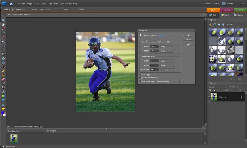

Image>Resize>Image Size
IMAGE: http://i72.photobucket.com/albums/i199/laserbug/Elements-7--A.jpg
Set document size to 13in X 19in and resolution @ 300 and select re sample image/ bicubic smoother ;)
