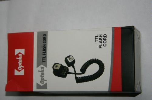

Jul 11, 2010 15:48 |  #13
will this guy make HSS work?
http://ecx.images-amazon.com/images/I/31​oYIMOgPWL.jpg (external link)
FlyingPhotog wrote in post #8905107 (external link)
The Speedlite has to have full communication with the body in order for HSS to work properly.
Your Choices for HSS are:
- On Camera
- Off Camera But With A Cord (Hotshoe Extension)
- Off Camera Radio Poppers
- Off Camera Flex TT / PW Minis
msowsun
"approx 8mm"
9,317 posts
Gallery: 18 photos
Likes: 416
Jul 11, 2010 21:13 |  #14
Yes.
