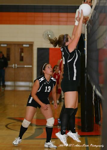

What I am looking for is some advice as to where to place them. On one end of the gym, is the doorways to acces the gym:
Photo to show the entry only:
IMAGE: http://i98.photobucket.com/albums/l267/motox424/0C4C0119.jpg

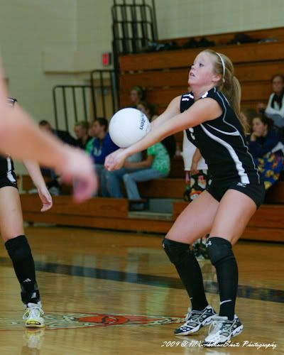

Then the other end has a white'ish wall with the orange & black padding, as seen in the 1st photo.
On the sides, one wall is a full set of bleachers with metal hand rails to the top:
Photo to show the railing only
IMAGE: http://i98.photobucket.com/albums/l267/motox424/0C4C0221.jpg
The opposite side has the same set up of bleachers, except that above them , there is a balcony with a railing all the way across. Sorry no photo of that

Bounce them off the whitish wall. Attached is a link to a post I did last year that shows where I positioned the strobes as well as some example images. Based on your sample images I think you could do basically the same thing in that gym. This is without a doubt my favorite setup if the gym works for it.
https://photography-on-the.net/forum/showthre​ad.php?t=603550
