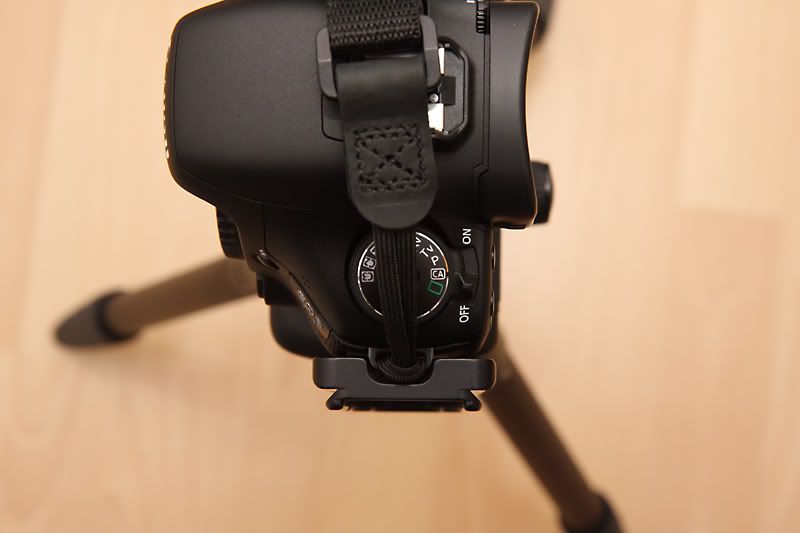

The dovetail on the bottom side of the plate is small and square instead of running the length of the bottom, like on many other RRS L-Plates. The square design of the dovetail allows the plate to be mounted in a clamp in both orientations, parallel to the plane of the longest side (length) of the camera, or perpendicular to the plane of the longest side (length) of the camera. This can be advantageous in applications such as using the clamp on a Wimberly Tripod Head II or certain video tripod heads. Another example, switching from a lens with a tripod mount ring to a lens without one; with a conventional camera plate on which the dovetail runs the full length of the plate, you need to turn the tripod or tripod head 90 degrees as you switch from the lens foot mount plate to the camera plate in the clamp. With the smaller square dovetail, there is no need to turn the tripod or tripod head.
Some of you (including myself) had concerns that the smaller dovetail may be unstable. It mounted solidly in the clamp on my Markins ballhead even though it is shorter than the length of the clamp. I also mounted the 7D with my 70-200 2.8L IS on, and it felt solid. Of course, with that kind of lens, I would normally use the lens tripod mount ring rather than the camera to mount on the tripod.

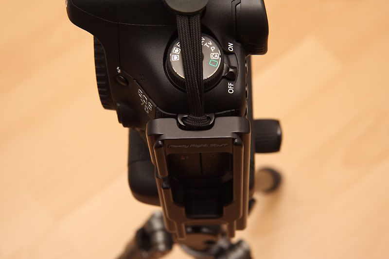

The dovetail on the vertical portion of the plate runs the full length. There is an opening to attach the remote controller to the port on the side of the camera. There is also a groove on the side of the L-Plate to make it easier to access and open the port covers.
At the very top of the vertical portion of the plate, there is a groove to fit the left-hand strap mount of the camera, so the strap won't be obstructed.
1. Top view. You can see the groove for the camera strap mount.

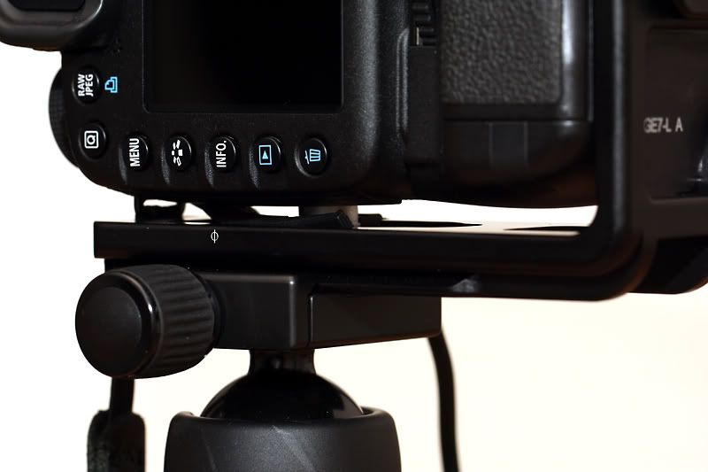

2. Another view from the top.

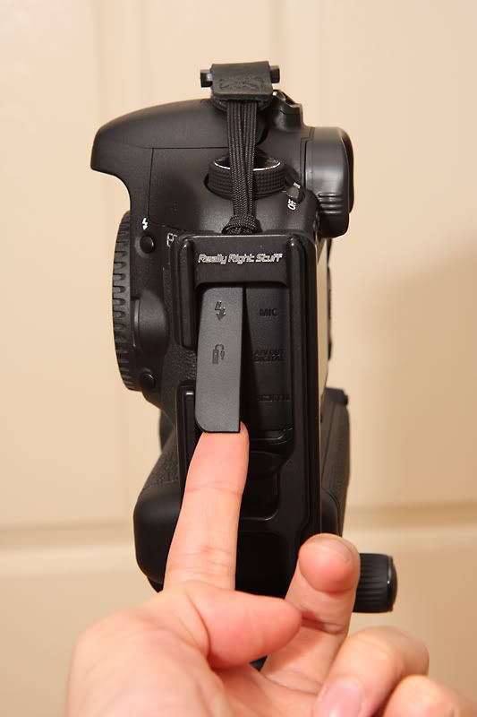

3. Side view.

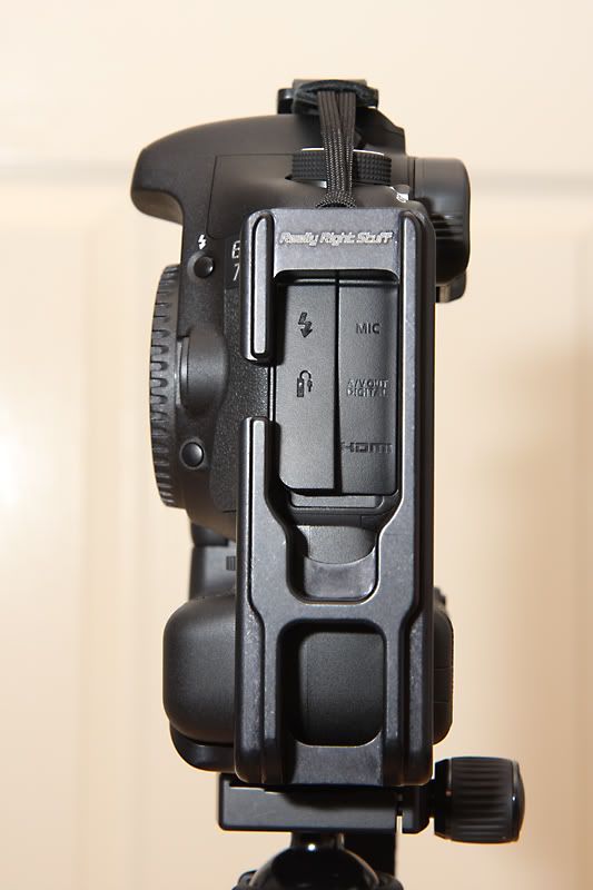

4. The port covers can be accessed easily.

5. Bottom view. The bottom dovetail is small and square, but it is solid.

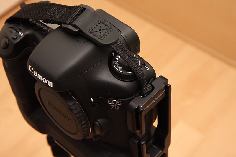

6. Just a different view.
