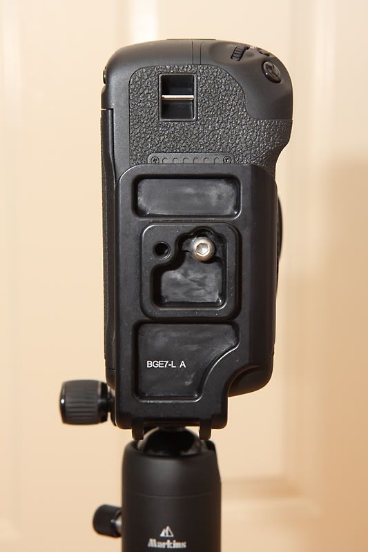

How is this a design flaw? The mount area is designed such that you can "slide" the L-Plate out for portrait orientation. It's a feature rather than a flaw. RRS accounted for the fact that the remote connector sticks out a bit. It's a non-issue in landscape orientation, and in portrait orientation it's compensated by sliding the plate into the second position.
In this photo, look closely where the screw is. There is a small notch right above it. That's the second position. You just have to loosen the screw a bit, but not completely, slide the plate, and re-tighten.
IMAGE: http://i235.photobucket.com/albums/ee312/krepta/IMG_9172PS-POTN.jpg
The way this is designed allows for the plate to be closer to the camera when the outer position is not needed.

i just looked at the RRS site (external link) and apparently they are aware of this. their product pictures show the same spacing to allow for the remote cable.
i see it as a flaw because they could have made the portrait side thicker. sure it would be a tiny bit heavier, but i'm sure they could have saved weight by milling most of it out. i'd understand if they did it to keep the distance between the center of the lens and the QR plate exactly the same, but it's not. you have to admit the whole thing would be rock solid if the portrait side of the L-plate was butted up against the side of the body. i get that you can butt it up, but you shouldn't have to space it out for the remote.

RRS did it for a purpose. I know because I called and asked about it when I bought my L bracket. They did it to make the bracket/body combination more compact when you use it without a tripod, which for me is most of the time. It saves a half cm when packing, and it's come in handy for me when packing this big 5D2 body in a small bag such as the Lowepro Classified 140 which I take in the evenings when on a trip. When you want to use the sticks, you move the bracket out.
Kirk makes the vertical piece of the L as a solid bar, which is a half cm thicker and makes your camera permanently thicker when trying to pack it. That's why I bought the RRS.
