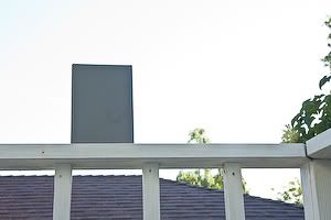

Two principles:
1. The selection of metering mode (Evaluative, Centerweight, Partial, Spot) only determines how the camera will emphasize one zone (or zone size) over other zones.
2. No matter what metering mode, the meter ALWAYS thinks the item within that zone is 18% gray in tonality, and tries to give an exposure the render that item as 18% gray tonality -- even if the item is white or is black, and not 18% gray! If the item is not 18% gray, you need to help the meter by use of Exposure Compensation (EC)
As for how Evaluative works, it biases the reading to the AF zone(s) which is used for focus, but gives some weight to the values seen in adjacent zones. Here is an example of Evaluative used on an 18% target, vs. using Spot to read that same target...
Evaluative, using AF point on the 18% card.
IMAGE: http://i69.photobucket.com/albums/i63/wiltonw/Evalcard.jpg
Spot measurement on the 18% card.
IMAGE: http://i69.photobucket.com/albums/i63/wiltonw/Spotoncard.jpg
Using a hand held spot meter on the 18% card.
IMAGE: http://i69.photobucket.com/albums/i63/wiltonw/handheld.jpg
