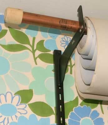

Good job if you need a portable one. I don't, so my solution was a few screws in the wall using a modified shelf support:
IMAGE: http://img.photobucket.com/albums/v218/PhotosGuy/Forum%20Junk/Backdropsupport.jpg?t=1260202082
