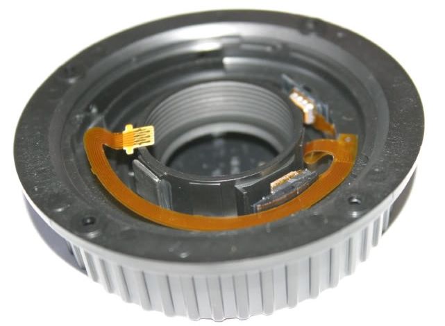

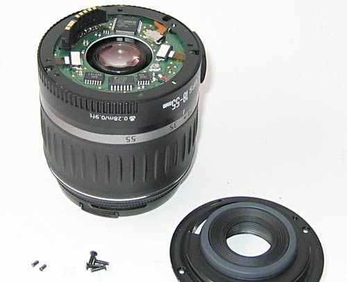

Mar 08, 2010 14:49 |  #14
I finally found a photo showing the wiring in the back of the 18-55 IS mount. It does appear as though it would cause a problem. It might still be possible to mod the mount to work on a 10D, but it will not be as easy as the non-IS version.
