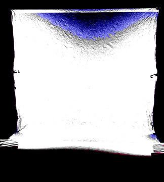

One more thing, I jacked the contrast on my pic from above to point out something. When the photo was taken, the entire backdrop was blinking, however some detail was recorded where the two circular light patterns didn't overlap. Since the backdrop is a shamefully wrinkled muslin... it can be easily seen.
IMAGE: http://i165.photobucket.com/albums/u43/111t/IMG_0023c.jpg
If the lights are moved sideways in towards the center of the set without tilting them this effect will be minimised. Also there is probably some latitude to lift the lights before detail starts to show on the bottom. Below that v-shaped area the background reads 255-255-255 from side to side. If the subject only occupies that area...then the v-shaped area doesn't matter at all.
