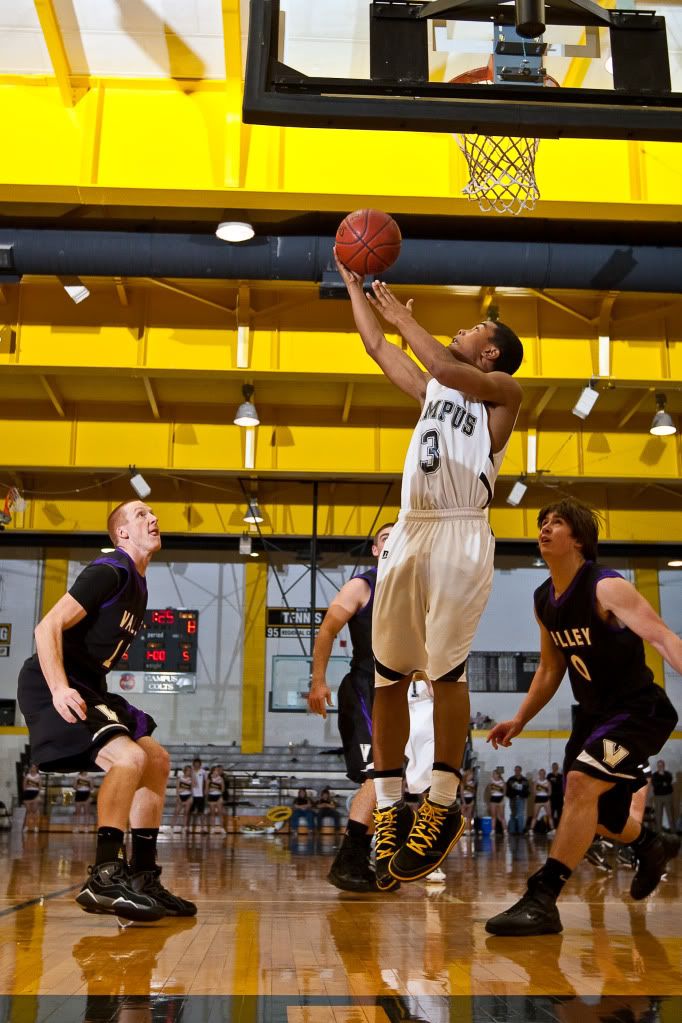

I feel your pain with the yellow/gold ceiling. Last Friday, I shot at this place that had the combination of both a white ceiling and huge yellow beams:
IMAGE: http://i137.photobucket.com/albums/q225/zivnuska/_ZIV7742.jpg

Yikes! At least this ceiling is completely yellow, so I shouldn't run into that problem. Those yellow beams are really distracting!
One issue I ran into this weekend was another gym with the box painted orange. I was getting some orange on the bottom side of players and nice color on thetop half of the faces. It wasn't nearly as severe as what you ran into there!
