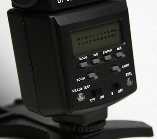

I attemped to test the flash in the sequence described in the instruction booklet.It stated the "On Ready" indicator light would come on when the power switch was turned to on,it did not but the ETTL light came on instead,by the way there was not any verbage that stated anything about the ETTL light coming on at this time.There was some changing of status going on on the LCD Monitor but stopped in a few seconds.I wanted to check the functionality of the LCD illuminator as described in the booklet.It stated the illuminator would come on when the light key was tapped and stay on for 5 seconds.It did not.............I decided next to test the flash as described in the booklet.The flash did appear to work properly.The instructions stated that if the flashgun discharges to wait until the ready light comes back on,I assume this meant before you could retest or take another exposure,it didn't denote either.It is really insignifcant at this point as the ready light never did come back on after waiting for 3 minutes.I thought maybe the batteries were discharged so I recharged them on a different charger,reinstalled them in the unit,the ready light never did come back on.

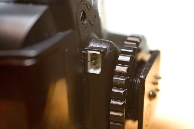

Does anyone know what the small plug is for? Battery pack, remote trigger, usb?

Found a hack for the sleep mode with remote trigger, you don't have to disconnect the green wire, just tap into it. Shoot in slave mode and it stays on when connected to a trigger/receiver:cool:
The slave sensor still works, but it will also fire the slave when not in slave mode if it sees another flash, a little tape over it cures that. I never use it as a slave anyway so I'll probably just disconnect the green wire.
http://globalize-this.org/iamthehomeles​s/?p=147 (external link)
