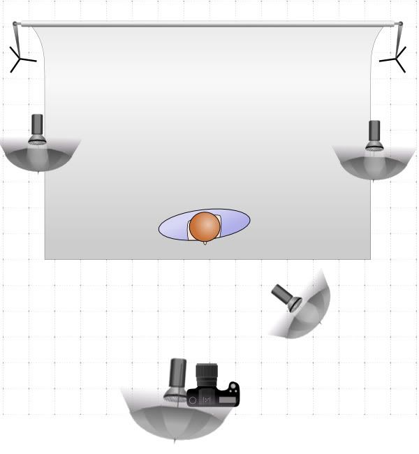

Here's a configuration that's worked for me. This is a 'clipping style' setup designed to blow the background out. Like the setup in the link posted above the backdrop I use is 9 feet. By using black backed umbrellas you can avoid the need to have those closet doors. It is essential that you point the umbrellas parallel to the set straight back. If you point them towards the center of the backdrop, you will have spill at the subject position. You want the seam of your floor material to be within the light spread of the background lights so that it will be blown out. The subject must be forward of the background lights effect, but not so far as to shoot off of the front of the flooring. One of the tricky things is to balance the light on the subject so that the floor in the foreground renders white and not gray. Inevitably it must be darker than the backdrop, but not too dark.
There would ordinarily not be a reason to clip the background... I use a muslin... therefore clipping is required to blow out wrinkles. Muslins are much easier to transport.
IMAGE: http://i165.photobucket.com/albums/u43/111t/white.jpg
I think you could probably get option 2 to work... but it will be much trickier than using another set of 200's because of the crudeness of the power adjustment on the 285's. If you use the first option, expect to have the background lights operating at or near max output.
All The best!
-Paul

111t, for a group shot would it be better for me to put the two subject lights at even 45º angles on the left and right for even lighting across the whole group, or stick with something like you did in your diagram using a main light and fill?

You could always use just one. It would evenly light the group.
