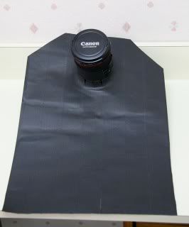

Gobo. Home made with gaffer plus black construction paper.
IMAGE: http://i137.photobucket.com/albums/q225/zivnuska/IMG_1275.jpg

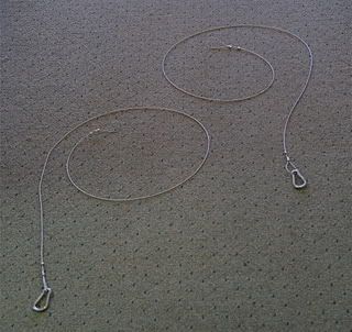

Safety cables
IMAGE: http://i137.photobucket.com/albums/q225/zivnuska/IMG_1276.jpg

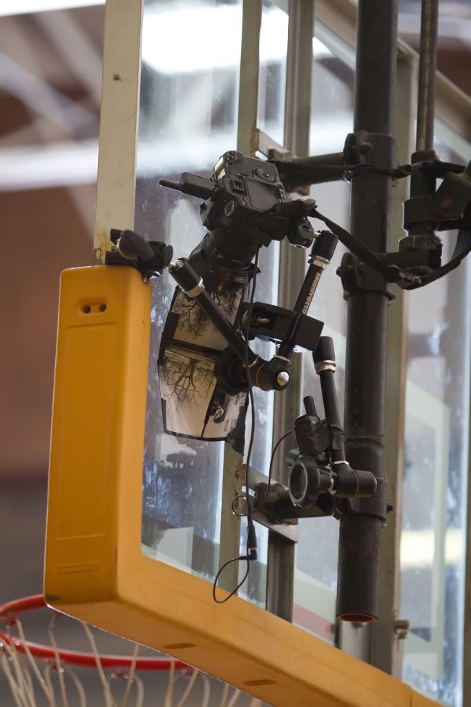

The mounting. Note the safety cables running to the brace on the top of the board. Two clamps, two arms, two safety cables.
IMAGE: http://i137.photobucket.com/albums/q225/zivnuska/IMG_1295.jpg

Thanks for your photos Phil, If you dont mind, can I see a photo of the way you have your safety cables?
