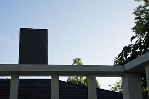

Evaluative biases exposure to the AF zone used for focus, but it still factors in the adjacent metering zones. As a result, Evaluative can readily be fooled about 'proper exposure' for a primary subject used to focus on. Here is an 18% gray card, which the AF point was used to focus, and which the meter used as highest priority to bias.
IMAGE: http://i69.photobucket.com/albums/i63/wiltonw/Evalcard.jpg
But now note what the 18% gray card should have looked like in tonality...
IMAGE: http://i69.photobucket.com/albums/i63/wiltonw/Spotoncard.jpg
