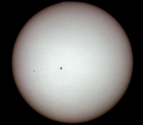

You can buy yourself some Baader Planetarium AstroSolar film (external link) and make your own white light filter to fit your camera lens or telescope..
Following is a picture I took through my 6" refractor with a white light(Solar Film) filter using a point and shoot digital camera for an afocal shot.
IMAGE: http://i68.photobucket.com/albums/i39/Tim_Kerr/whitesolar.jpg
But, If you want to see the red molten granularity, flares and solar prominances then you will need the more expensive H-Alpha Solar filter or Solar Telescope. One of the more popular Ha solar scopes was the Coronado PST.

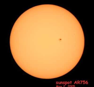

The cheap filters- galss or baader let you take a photo fo the sun as a smooth surface and the dark sun spots, but if you want to see the filaments and prominences, you need a good set of HA filter/scope...solarma​x brand (by Coronado/meade) are small one $500- $4000 scopes but cannot be attached to the dslr...here is a sample of a a $100 thousand oaks filer connected to an Orion 80 ED then to a DSLR in this case a Rebel xsi:
