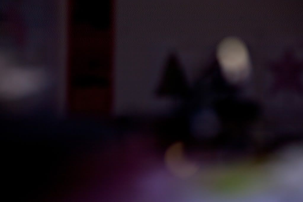

I have just noticed my 5D (mark 1) doing this recently .. consistently, when taking photos an odd horizontal banding appears in the top quarter of the image. eg -
IMAGE: http://i893.photobucket.com/albums/ac132/edu889/_MG_1220-1.jpg?t=1268543164

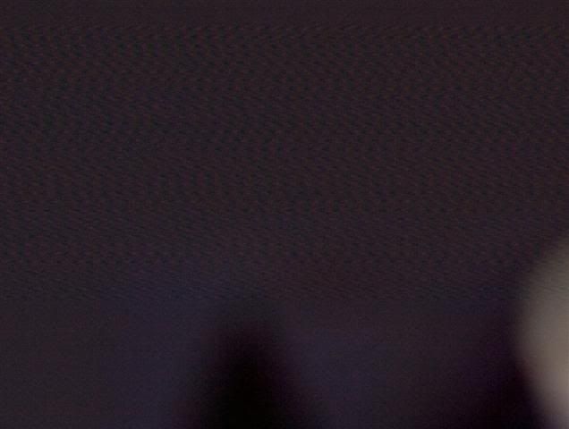

and closeup:
IMAGE: http://i893.photobucket.com/albums/ac132/edu889/_MG_1220-1-2Small.jpg?t=1268543164
I tried searching the web but haven't found any answers. Has anyone else come across this? Is my sensor fubared? :(

Cactus Trigger transmitter on top or other nearby source of RF?

yep...cheapie flash triggers?

Yep. That herringbone pattern is the signature of RFI (radio frequency interference).
Funny, this problem seems to come up with 5D (first generation) more than any other Canon...

Thats usually caused by some kind of wireless flash triggering. The rf 602 triggers don't seem to do it for me tho =)

thanks guys, removing the ebay flash trigger did indeed work :) odd ... could have sworn i've used it before on the 5d before without problems. is there any way to prevent it from happening? I don't really have any money to afford pocket wizards or something similar for my flashes.
