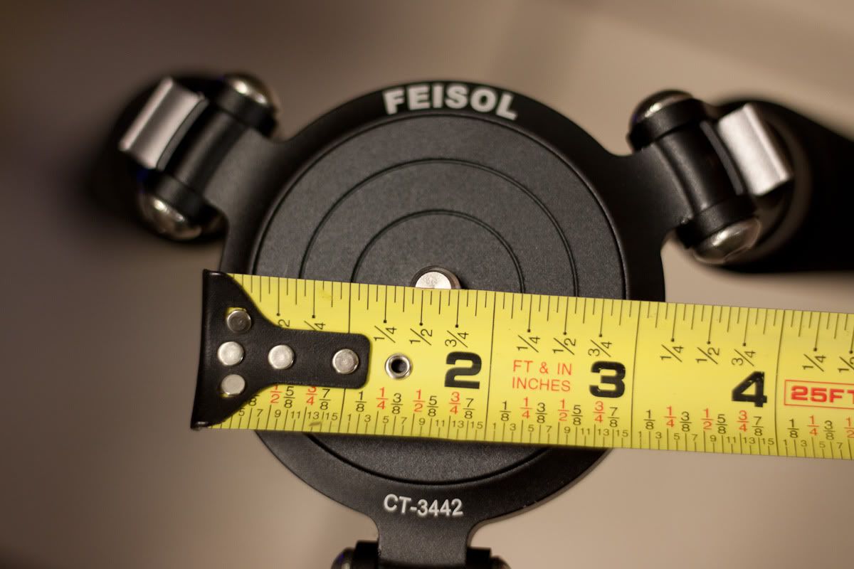

I remember talking to Kerry about the largest possible ballhead to fit the CT-3442 and i'm pretty positive that he told me not all will fit.
I couldn't find the email to verify it.. but i did some measurements.
The base on the CT-3442 measures 3-3/16" across.
IMAGE: http://i105.photobucket.com/albums/m223/Jdmhoodz/IMG_0333.jpg

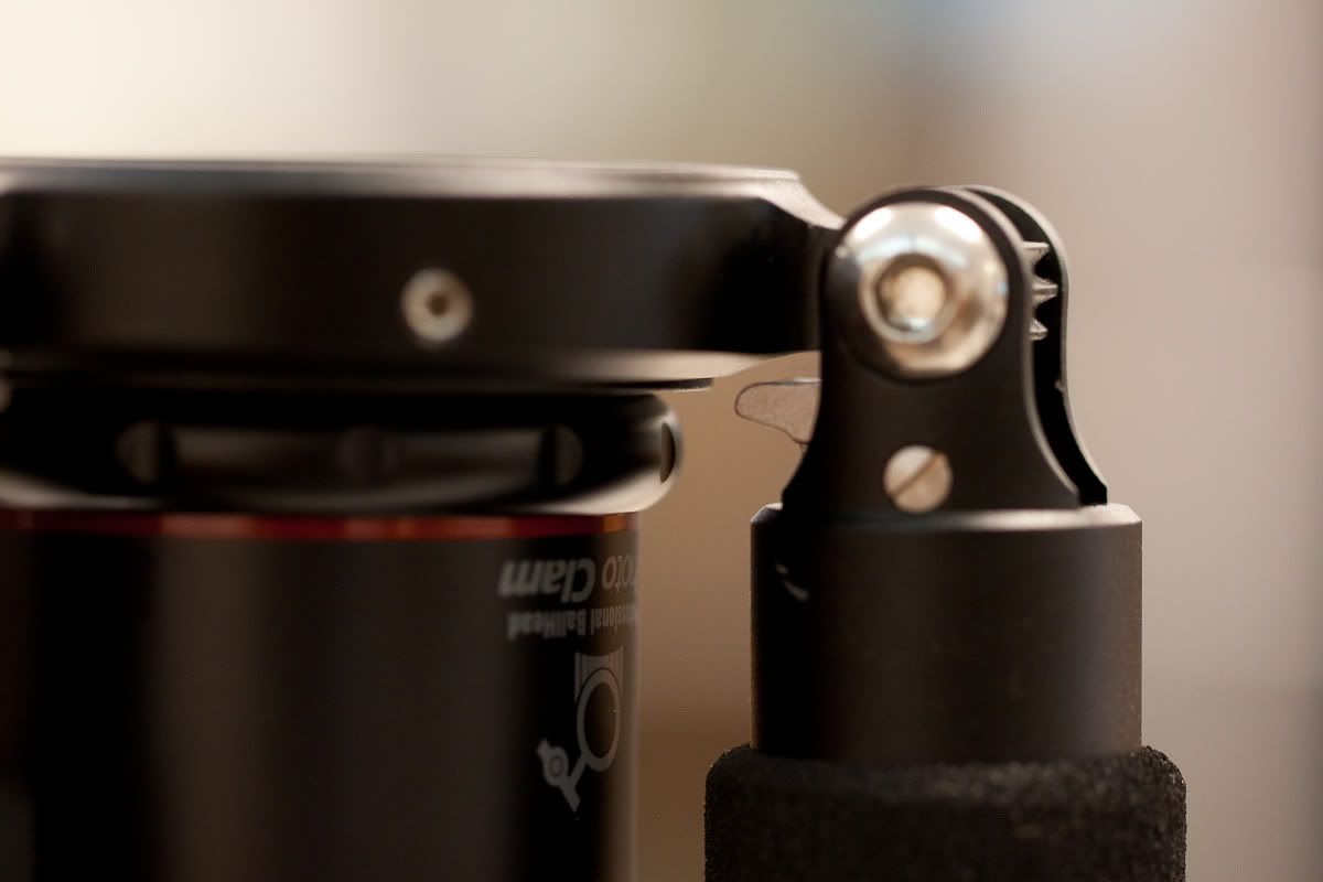

My PC-44NS fits comfortably on it since the panning base diameter is only 2.48"
The panning base on the PC-74NS is 3.78" across which is significantly larger then the base for the CT-3442.
Also when reverse folded. The latches eat up even more room.
IMAGE: http://i105.photobucket.com/albums/m223/Jdmhoodz/IMG_0337.jpg
I have a hard time believing that PC-54NS fits on there. For that matter, i doubt the PC-48NS will fit with the legs reverse folded.
Not not the OP will buy ballheads of that caliber. In fact, i think the chances are slim. But i just don't want anyone to be confused. ;)
