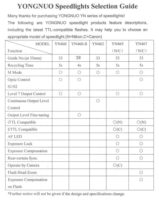

BTW,,the Yongnuo YN-460II guide number of 53 is at 200 ISO not 100 ISO as most flashes are rated..

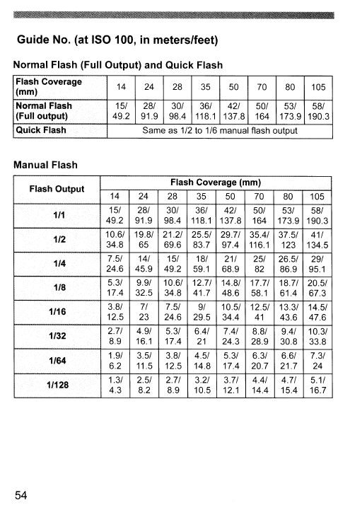

That makes it more powerful than a 580EX II. I wonder how true those specs are?
580EX II specs
IMAGE: http://i2.photobucket.com/albums/y17/msowsun/photo%20stuff/Photo2/_1-13.jpg
