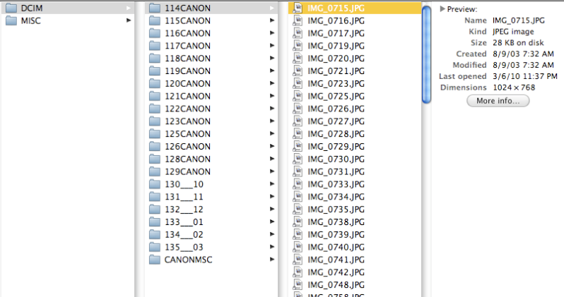

i've had success loading photos dating back to 2003 onto my SD card, over two thousand of them in fact. you will need to create folders with a lower sequence number, for example if the oldest folder on your S90's card is 130_10 then name it 129_09 (129CANON might also work, as it does on mine because i've used other canons in the past and that was their naming convention). you may also need to rename your images.
this is what it looks like:
IMAGE: http://img.photobucket.com/albums/v312/pvincent/folders.png
good luck.
