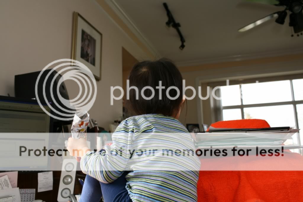

Here's a quick nasty. Flash is never abused and never been in the thermal shutdown mode. CFN has been cleared too.
These pictures with exif will not help anyone analyse. Still cant believe 2 units ended up like this.
Over 50% of a set of 15 slowly shot did this kind of exposure.
