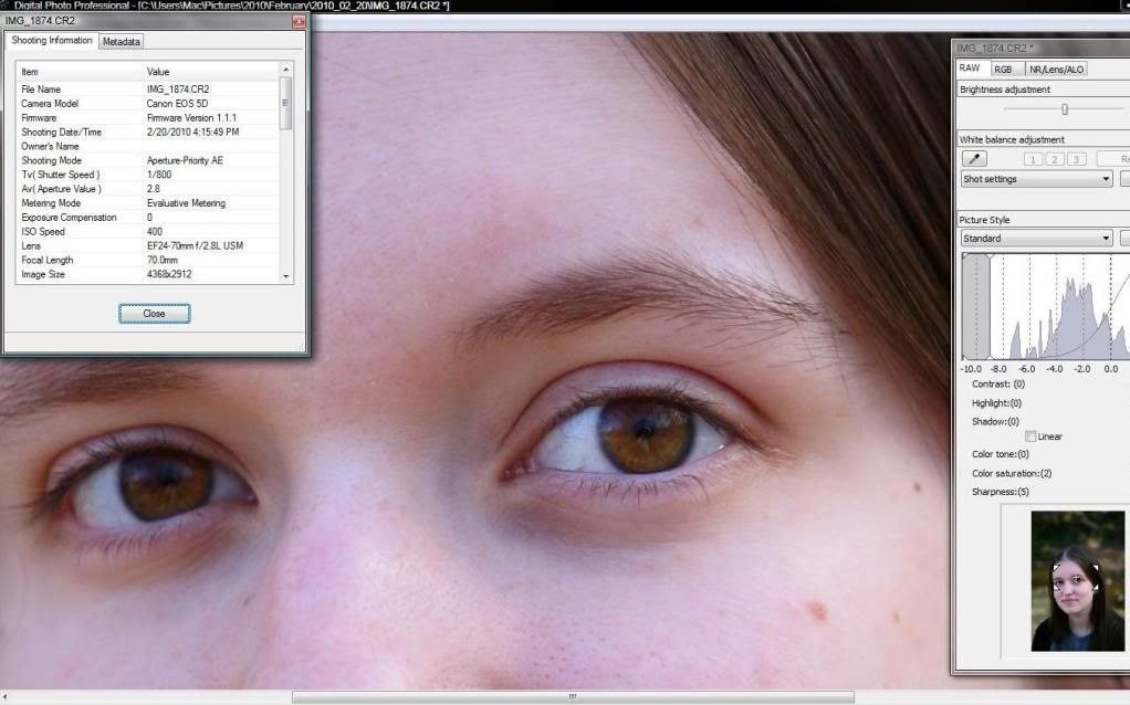

Psssh. Print Screen while viewing at 100% in DPP so we can see the picture and post the print screen into paint.
this is how you crop :D
IMAGE: http://img.photobucket.com/albums/v518/plasticmotif/Untitled-7.jpg?t=1270689748
