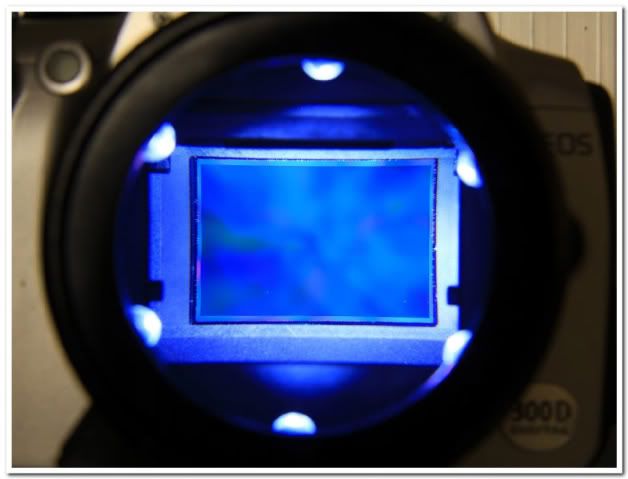

When it comes to the sensor, a sensor loupe is invaluable to spot the dust particles and the Arctic Butterfly removes 99% of the particles on the sensor.

where did you get that loupe from? i love the fact that you can see the streaks on your sensor.
got a link?
