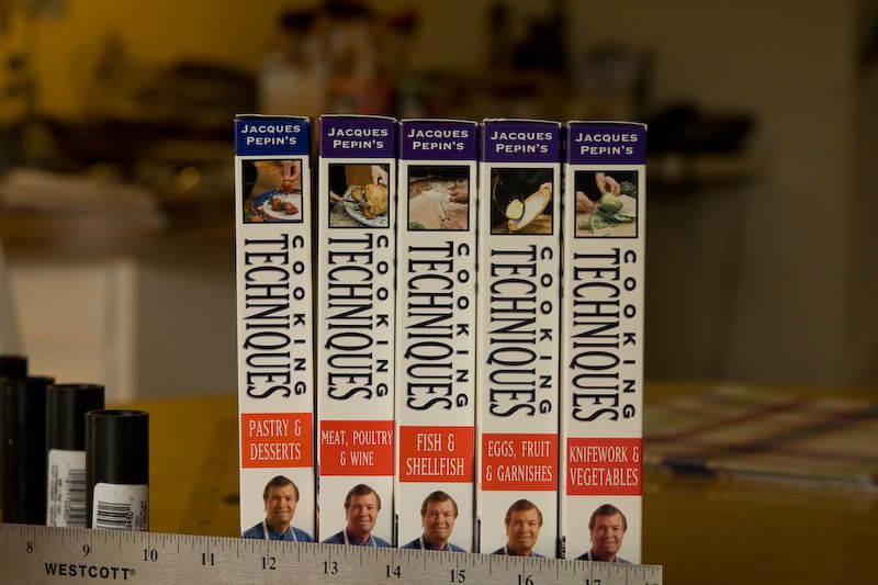

Here is a way to test for front focus...focus on the box front, and look at the ruler.
IMAGE: http://i69.photobucket.com/albums/i63/wiltonw/Principles/IMG_4013.jpg
Here is an example of perfect focus, using a 70-200 f/4 IS at its minimum focus distance. In this example, the '9' on the ruler is exactly aligned to the front of the target VCR tape box used for AF, and it is clearly in sharp focus, indicating good AF alignment.
IMAGE: http://i69.photobucket.com/albums/i63/wiltonw/Focustestfullsize-1.jpg
