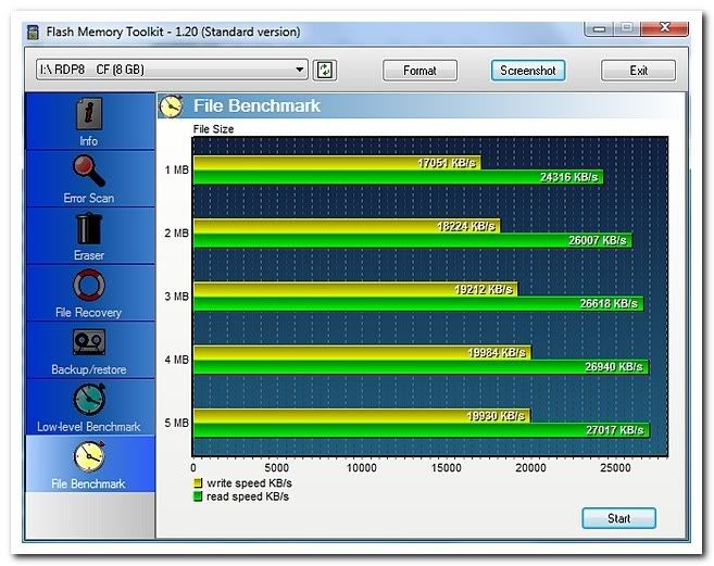

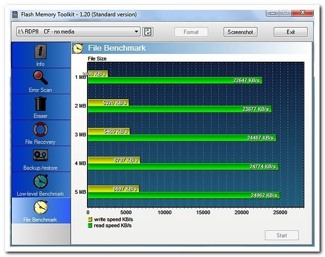

I did a quick speed test with some of my compact flash cards, to show that the performance claims of some CF cards are misleading.
These graphs show the relative performance of the cards, not the absolute performance, as the usb 2.0 interface slows things down a bit.
1) Sandisk Ducati 8gb - claimed write speed of 45mbs
IMAGE: http://i81.photobucket.com/albums/j226/lannes2007/sandiskducati8gb45mbs.jpg
2) Pendrive 32gb Professional series - claimed write speed of 40mbs
IMAGE: http://i81.photobucket.com/albums/j226/lannes2007/pendrive32gb40mbs.jpg

Conclusion
If the Sandisk writes at 45mbs per second (which is reasonably accurate) then the Pendrive is only really rated at round 20mbs (not the claimed 40mbs) and the Transcend is also slower at around 12 mbs (not the claimed 20mbs). As you can see the a lot of performance claims are false, so it pays to buy the most reputable brands.
