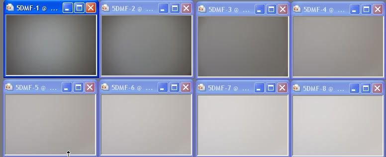

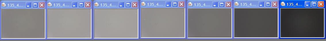

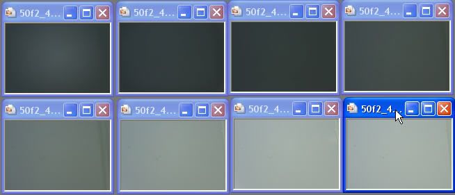

May 01, 2010 16:14 |  #6
bohdank wrote in post #10101948 (external link)
Wilt posted some tests he did with a number of different lenses to illustrate the point.
Test with five different manual focus non-coupled lenses on a Canon 40D (and the last text, below, with the 5D), showing the fact that as the aperture is stopped down the meter does not respond in a linear manner at all. I have found the best way to use any of these lens is to stop down to f/4 and meter, then alter both the shutter speed and aperture in a similar manner! (For example, if you want to shoot at f/9, you adjust aperture -2.33EV and alter shutter speed +2.33EV. Otherwise metering is absolutely NOT reliable!!!
IMAGE: http://i69.photobucket.com/albums/i63/wiltonw/Principles/135_f28_40D.jpg
IMAGE: http://i69.photobucket.com/albums/i63/wiltonw/Principles/28200_f35_40D.jpg
IMAGE: http://i69.photobucket.com/albums/i63/wiltonw/Principles/40D_50f14.jpg
IMAGE: http://i69.photobucket.com/albums/i63/wiltonw/Principles/50_f2_40D.jpg
IMAGE: http://i69.photobucket.com/albums/i63/wiltonw/Principles/5D_50f14.jpg
In all the illustrated series, the f/4 exposure is the correct density, and all the other exposures ought to be the same density, but are not!!!
Three of the lenses resulted in metering OVERexposing as you stopped down past f/4, but two resulted in metering UNDERexposing as you stopped down past f/4; and as you opened up wider that f/4, the error would be in other direction. One post claims that the EF-S focusing screen in the 40D would make the exposure error go away, but that has not yet been proven with sufficient testing.
