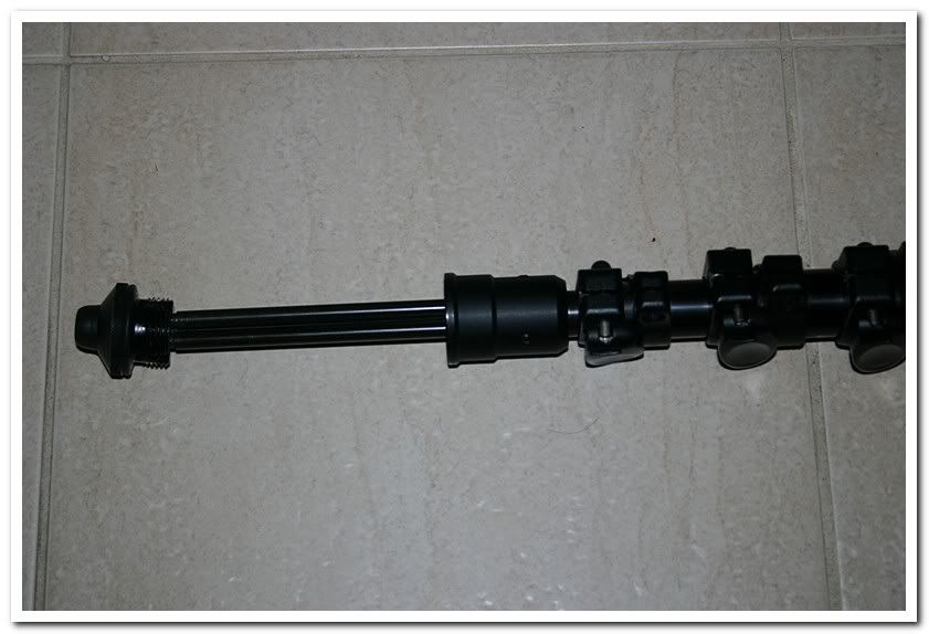

The legs on the 682B, should fold up into the monopod leg, until you want to deploy them.

Thanks for the pic. I must admit, though, I don't exactly know what I'm looking at there. Is the bottom of the monopod to the left?

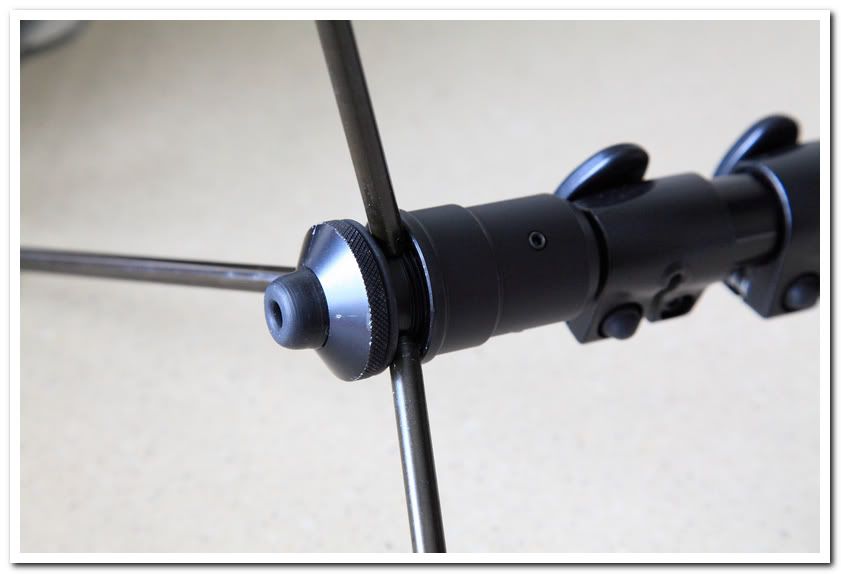

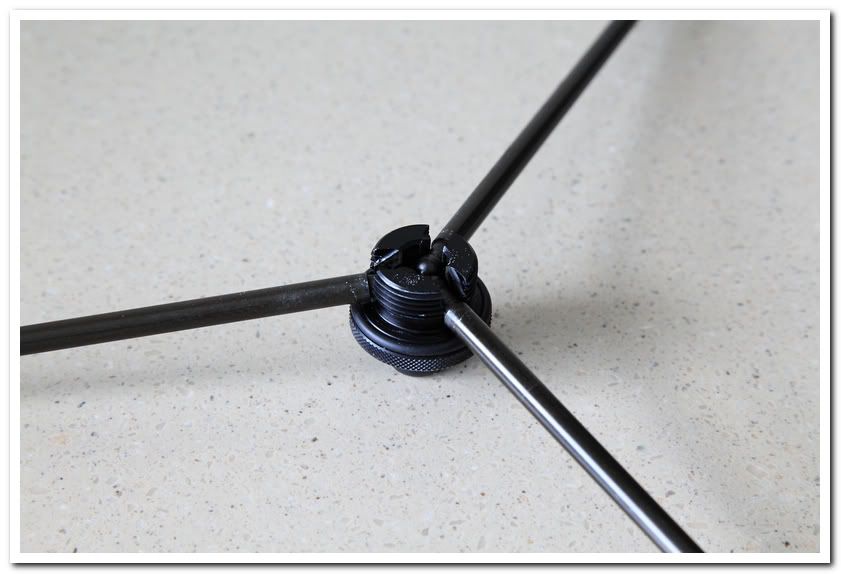

The picture is of a 680B with a universal folding base, this should be similar to the 682b which is a 2 section monopod. The 680b is 3 sections but shorter.
You basically unscrew the bottom part of the monopod and the legs pivot out, you then screw the bottom cap back into the base and the legs are sandwiched between the cap and base holding them securely.
I went with the 680b as it was more compact when minimised, but if you need the extra height then the 682b is what you will need to go for.
Here is a link showing the 682b
http://www.dilipmurali​daran.com …elf-standing-monopod.html (external link)
Hope these give you a better idea.
