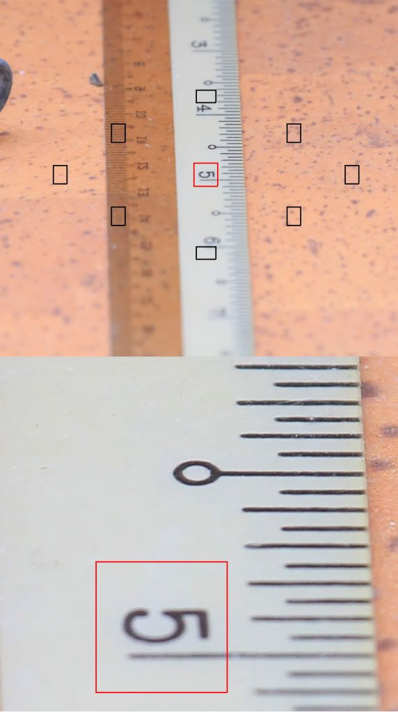

heres the test on ruler:
it was back focus abit too.... (the red cube is the center focus point, focus on the 5 horizon line)
my 50mm is abit front focus too :(
indoor using flash bounce (it just next to window and the sun light is main light)
70200 @f4:
its so blur... :cry:
IMAGE: http://i1024.photobucket.com/albums/y304/ph20088/70200_chart_f4.jpg
70200 @f5.6:
still blur.....
IMAGE: http://i1024.photobucket.com/albums/y304/ph20088/70200_chart_f56.jpg
70200 @f8:
ok this is sharp.... :P
IMAGE: http://i1024.photobucket.com/albums/y304/ph20088/70200_chart_f8.jpg

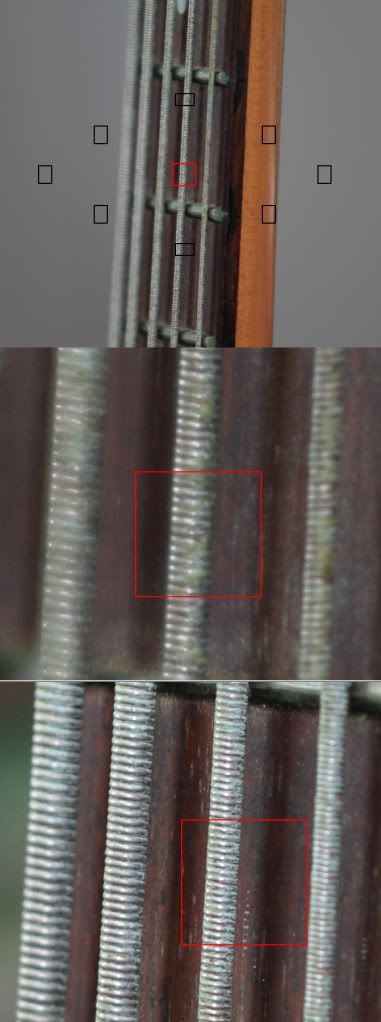

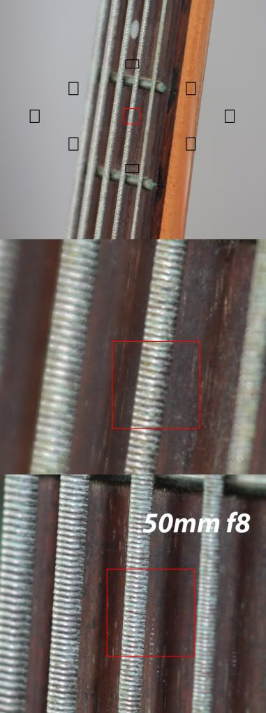

another indoor test with the 50mm 1.8II
f4:
IMAGE: http://i1024.photobucket.com/albums/y304/ph20088/70200_guitar_f4.jpg
f8:
IMAGE: http://i1024.photobucket.com/albums/y304/ph20088/70200_guitar_f8.jpg

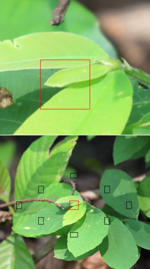

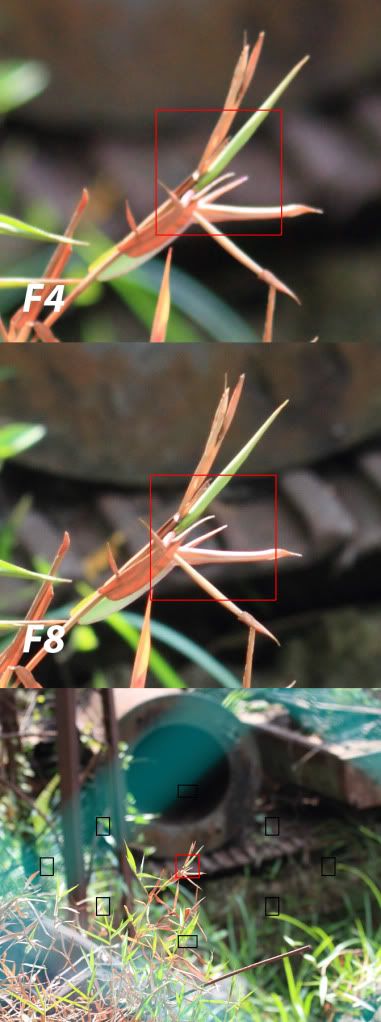

some outdoor test
70-200 @f8
IMAGE: http://i1024.photobucket.com/albums/y304/ph20088/70200_leaf_f8.jpg
70-200 @f4
IMAGE: http://i1024.photobucket.com/albums/y304/ph20088/70200_leaf_f4.jpg
70-200 @f4 vs f8
IMAGE: http://i1024.photobucket.com/albums/y304/ph20088/70200_farGrass_f4-8.jpg

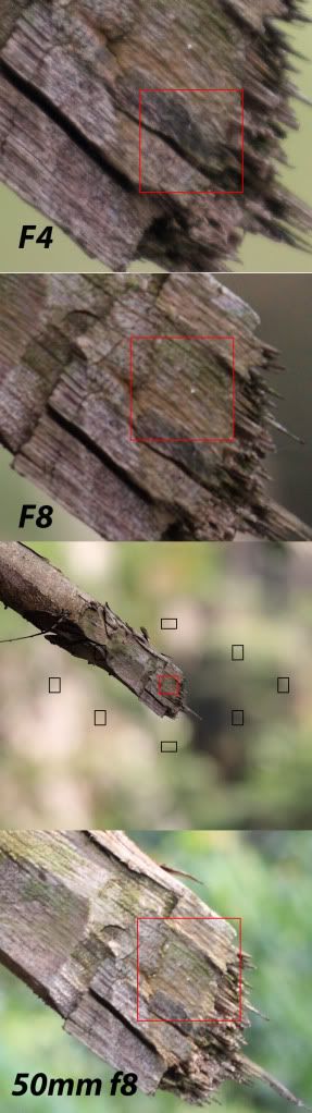

70-200 vs 50mm @f4-8
IMAGE: http://i1024.photobucket.com/albums/y304/ph20088/70200_wood_f4-8.jpg

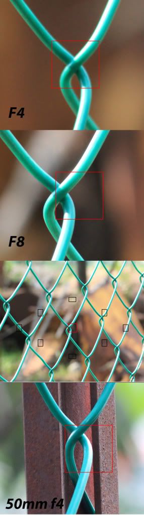

IMAGE: http://i1024.photobucket.com/albums/y304/ph20088/70200_fence_f4-8.jpg

This lens should be very sharp wide open. However, it does have one weakness - it's not very good at the minimum focus distance. How close were you to the subjects?
Also, I wouldn't recommend shooting leaves outdoors because there's always a chance of a bit of wind to blow them around a bit.
Finally, if you are using a filter take it off the lens and try again.
Jo

ok well most of the shoot r very closed to mfd.... man i didnt know it has weakness point :(
anyway i will try out tomorow (its getting dark here now) and few more step back!
thanks for the heads up, will let u know how its goes after :)

What were your shutter speeds? Seems alot like motionblur to me.. and de ruler @ f8 shows some backfocus, did you use a tripod?

Indeed softer than what it should be , you wouldnt be having a dirty filter on eh ?

MFD and wide open doesnt leave much depth for shooting 3d subjects, especially if you are getting any motion blur in the mix. I've generally gotten much sharper results than that however, but I havent delved that deeply into pixel peeping.

I would test much farther from the MFD for a telephoto lens. It's definitely unusually soft for that lens. Do you have any kind of a filter on?

Yup, the ruler at f4 shows nothing in focus - so it's not a back/front focussing issue. Sure does look like too slow a shutter speed handheld.
The back focus on the f8 shot could also be down to unconcious recomposing after focussing (I had a friend who could never get anything sharp close-up; she was focussing, then moving a little closer to get the composition right).
A tripod will help enormously with both problems.

Or a clean, cheap, one?

Motion blur from a slow shutter speed. IS is only so good you know.

the ruler test was mount on a tripod, it was at the closest mfd 1.2m (i remembered it coz i tired to move the tripod infront 1mm it wouldnt focus at all even i using MF. :P
and yes it was back focusing as u can see when its at f8.
im using hoya HD, i think this filter will be fine :)
i did removed it at indoor test.
