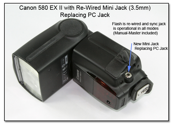

I switched over to 1/8" mini jack after a couple of months of frustration with PC sync.
I've added mini jacks to all of my flashes as I just can't be bothered with troubleshooting every time I set up.
I didn't go with hotshoes with cables built in as I would prefer to be able to switch out cables quickly and easily if there are ever issues.

Jannie wrote in post #10553112 (external link)
I use skyport receivers and attach them to the aide of my speedlights with Velcro so they don't move. I use flashzebra screw PC cords and coil them up and tape the coils so they stay out of the way. Occasionally one of them stopps working and I have to retighten the PC connector, would love to have 1/8" jacks in my 580EXII's.
Do it.
http://michaelbass.blo​gspot.com …h-auxillary-sync-mod.html (external link)
IMAGE: http://3.bp.blogspot.com/_CRxbBKkoqIY/RwRkkWIrWyI/AAAAAAAAAgA/FhT-tP7LEZU/s1600/580EXII_MiniPlug.jpg
