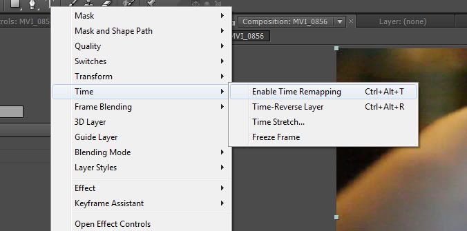

Then open up AE and make a new comp. Make sure the comp is longer than your clip. Put your footage in to the comp and right click it. Choose Time- Enable time remapping.

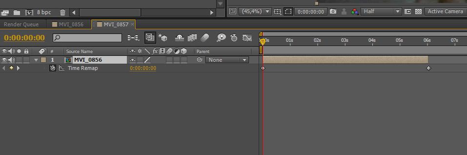

Then there should be the time remap effect and a couple of keyframes in the layer.
IMAGE: http://i206.photobucket.com/albums/bb222/Pingiivi/Untitled-2.jpg
The first keyframe tells where the start of the clip is and the last one tells where the end of the clip is. You can make the clip faster by bringing the last keyframe closer or slow it down by moving it farther. There's also the possibility to ramp the speed around by making more keyframes, but that's another story.
So move the keyframe towards the end of the comp and stretch the end of the footage to the keyframe.
