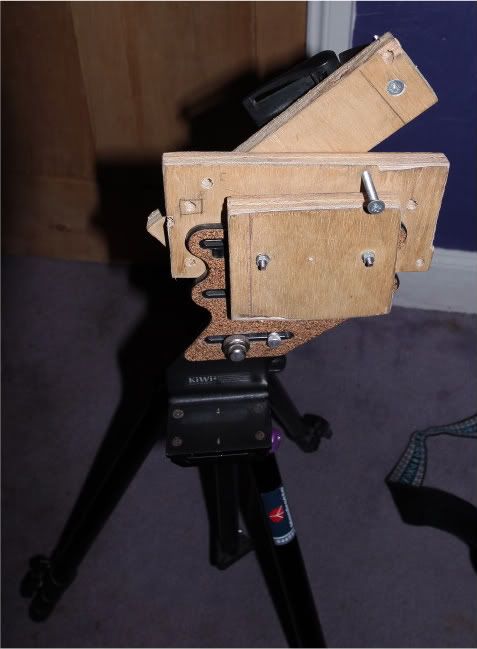

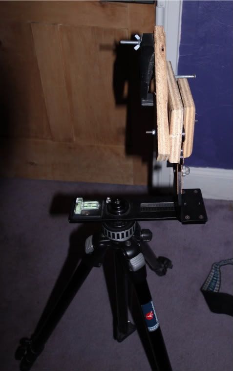

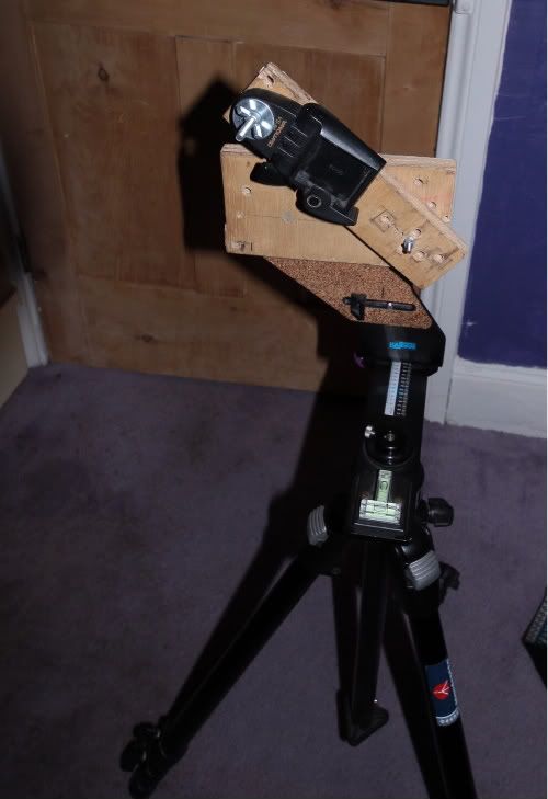

just seen a couple of your other threads on this project of yours and with regards to the tripod i would suggest getting one which will actually pivot around the nodal point of the lens. either a real one or one like mine :lol::lol::lol:.
I was fortunate as i bought the manfrotto landscape tripod from a friend for £150 and then spent about £3 to knocked up this out of some scrap ply a few bolts and a tripod head from a spare cheap tripod i already had. as you can see it is not pretty but id does the job and pretty well. it now rotates horizonatally and vertically about the nodal point of the lens. took about 2 hrs to make and about 1 hour to fine tune the exact nodal point ... hense some additional drill holes :lol:.
i have 4 presets for putting a bolt through to give me good overlapping and then just do the full 360 degrees with 3 shots (-2 0 +2) every 20 degrees. Run the files through photomatix for HDR and then into PTGUI to stitch. Ptgui can stitch for HDR out put but it takes a lot longer for it to do it and i find it more cumbersome that way.
