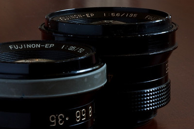

You can spend $40 to $50 and have a very small, very sharp and very easy to use macro lens.
M42 Manual tubes, macro is all manual focus. Enlarging lenses, I would start with something 90mm and no longer than a 135 lens. The tubes run about $15 used and the lenses are between $25 and $50.
I have an article on using enlarging lenses with bellows - but tubes do the same job and are portable.
https://sites.google.c​om …xpensivemacroph​otography/ (external link)
IMAGE: http://stover98074.smugmug.com/Flowers/Macro-Flowers/IMG8545/839466346_Xpwce-S.jpg
Canon XSI, Asahi Pentax Auto Bellows, 50 Fujinon EP, 80 El Nikkor, 105 El Nikkor, 135 Fujinon EP

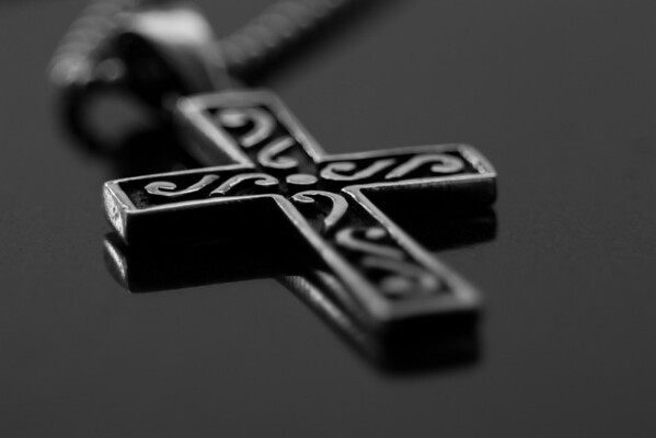

Economically, extension tubes would be the way to go. But, for versatility, the macro lens would be better. If you are using the macro lens for the ring shots, and all of a sudden something interesting happens, you can swing the macro - re-focus, and get the shot. If you have extension tubes installed, it will take time to get back to a regular lens - unless you have multiple setups.
That is a good point, with tubes you will loose some flexibility to capture non macro or close up photos - it will take a moment to remount a normal lens.
However, you can get close and some unique out of focus capabilities. The photos were taken with a 135mm enlarging lens.
While not a ring, this is an example of a small pendant on a black granite tile.
IMAGE: http://stover98074.smugmug.com/Other/Sharing/IMG7808/990252213_Qetf7-M.jpg
This is another example with an enlarging lens. The glass lens is about the diameter of a man's ring.
