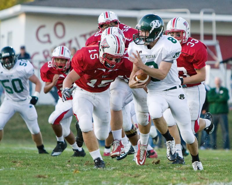

Last season I rigged up my flash. Didn't get good results. User-error, most likely. Also tried to save a bunch of money for a 300 f/2.8 to shoot with this year. Came up about $2k short on that one.
I'm playing with the cards I have right now ... a 70-200 f/2.8L on a 7D, no flash and sideline access to games of our local HS. Here are some examples from pre-game through 4th quarter in complete darkness under the lights of a very well-lit HS facility.
1) 6:00 pm. Pregame was overcast Friday night

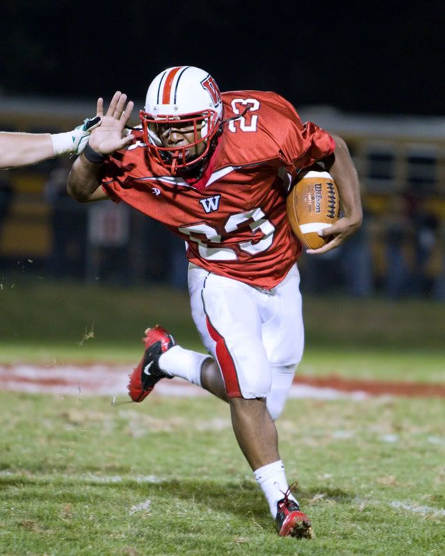

2. 7:10 pm first drive of the game

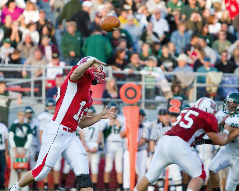

3. 7:30 and second drive of the game.

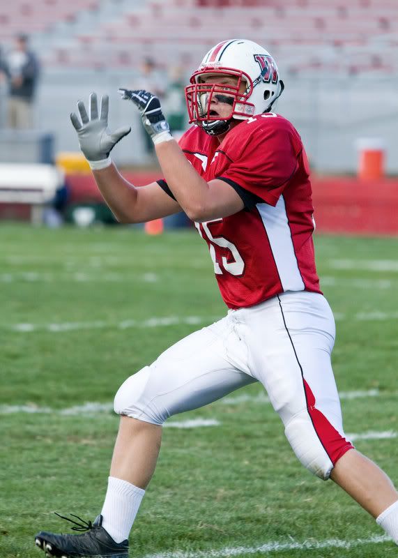

4. 2nd quarter, probably 8:15. Daylight almost gone, stadium lighting taking over. WB still reasonably good.

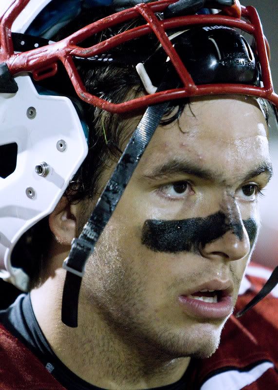

5. 8:30 pm. It's dark. Start of 2nd half.

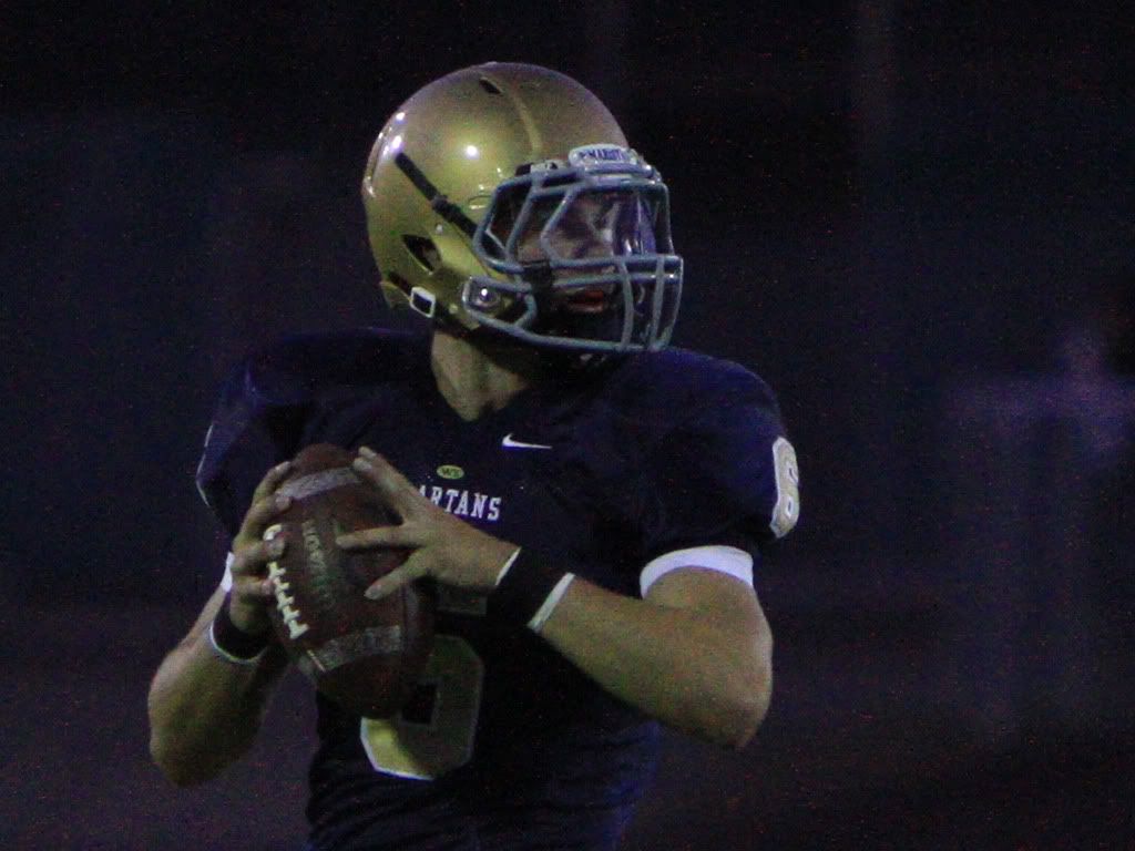

6. 8:50 pm 3rd quarter. It's all the way dark. Only light is artificial at this point.

7. 4th quarter. After 9pm. Pitch black outside stadium. WB is horrible!

Shooting with a 70/200 f/2.8 and no flash is what it is. I'd like to have the longer lens and a 580 EXII with a battery pack that allows for burst shooting. Would have exacting WB and some real 'pop' to the color.
And in the hands of a better shooter, the results would likely be better with the gear hand I'm playing with this season. All things considered, I'll take it!

You can see the noise pop up in the last two and in the 2nd to last some motion blur but if you always shoot in that good of light you might get away with it? At the fields I have gone to no way flash is a must. What did you have your ISO up to in the last few?

Only about 2500 and was still getting 1/640. Probably should have gone higher to get closer to 1/800 or 1/1000 on the shutter. That last shot could have been underexposed a bit and corrected in post. I see the noise as well. Thanks for pointing that out.

Your high school field lighting looks pretty good. I shoot football all over the area and the lighting, especially the red component of the light, is different from school to school. At some schools, because of the lights, I throw away 50 to 75 percent once I'm shooting in full dark. At other schools I don't have to throw away any because of the lights. It's just something we have to deal with.

thanks for the info on the reds. Glad it isn't just me. Under our home stadium lights, kind of a copper/orange/red is about the best I can reproduce in post!

Back on topic, try a custom WB using a $5 gray card. You'll probably have to do a couple during the game as ambient fades but it'll correct a good deal of the WB problems and is dirt cheap. I'd also shoot RAW if doing ambient football as it does offer a little latitude in post. Nice work again man. See ya.
