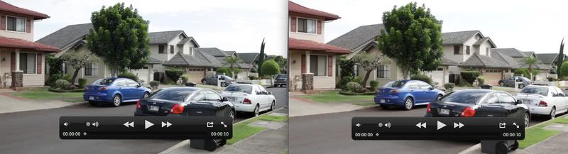

Here are some sample photos to give you guys a better idea of what I'm talking about. These are screen shots of the video playback. (We've also noticed that the 5D tends to be much more contrasty and has better saturation).

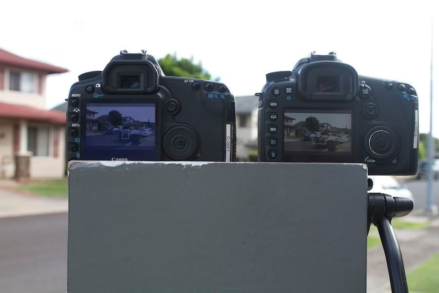

5DMKII on the left, 7D on the right. Both cameras were set to the same exposure, 5200k. Both shot with a 24-70L. Profiles set to Neutral.
IMAGE: http://i96.photobucket.com/albums/l192/jnakatsu/5d2vs7dOutside.jpg

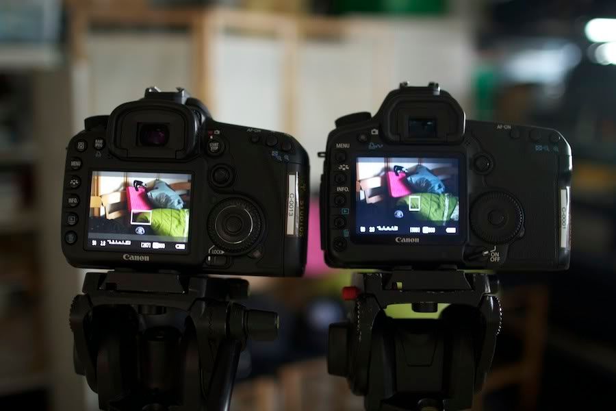

And now here is a picture of the LCD screens. Again, 5DMKII left, 7D right. As you can see, the 7D is accurately matching the exposure, and the 5DMKII has a really bad magenta cast.
IMAGE: http://i96.photobucket.com/albums/l192/jnakatsu/5d2vs7d.jpg

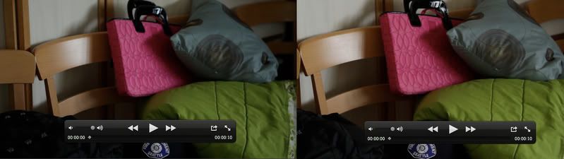

Again, this time indoors. 5DMKII left, 7D right.
IMAGE: http://i96.photobucket.com/albums/l192/jnakatsu/5d2vs7dInside.jpg
And lastly a photo of the cameras (This time I switched their places after taking the video to make sure it wasn't an angle issue. 7D left, 5DMKII right)
IMAGE: http://i96.photobucket.com/albums/l192/jnakatsu/7dvs5d2.jpg

The rear view LCD is not meant to be accurate in anyway. It's far to heavily compromised by its need to be small, thin and durable. It should never be used for checking anything more than composition, histograms and changing menu settings.
Fortunately both bodies have mini HDMI out puts so you can view video on a proper field monitor. There are plenty of small models designed for doing this, and you can even by rigs that attach them to the camera.

The 7D and 5D MK II won't give the same White Balance in images - one shoots a bit warmer, one a bit colder - you can only try to compensate by using a set Colour temperature.
About the screen - it isn't accurate as Moppie said - and as lannes said, that colour cast isn't normal on the 5D MK II.
Edit:
Your 5D's screen isn't set to max. brightness by any chance? That might cause it... even on auto you have 3 levels it tries to reach - "dark, medium, bright".

It's not that one shoots cold and one shoots warm - it's that the 5DmkII screen doesn't match the resulting footage. The 7D's does.
And in the first photo screen brightness is all the way up.
Second photo screen brightness is set to the default.

So if identical WB settings produce matching footage from each, where's the problem?
A quick test shot from each when you get on site to confirm that you're within spec and then go to work.

Well my testing shows that the WB's between the two cameras match closely enough, and we never shoot AWB.
