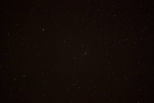

Thread started 06 Oct 2010 (Wednesday) 03:10

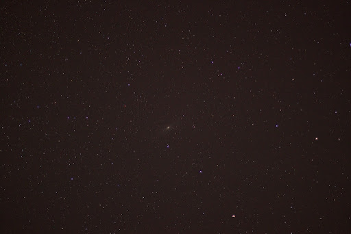

Thx atomsmurf, your M31 capturemotivated me to try with almost same set-up as you, I used T1i/Canon 50mm 1.4 prime.
My method: Manual focus on Jupiter (got as small/defined circle as possible), found M31, used ISO800, 4 sec exp, f1/4 (wide open!).
133 light frames, 31 dark frames, 20 bias frames:
1 light frame with exif data for reference straight from camera:
IMAGE: http://lh6.ggpht.com/_FqTNmgNQHz8/TKwrLDZJUlI/AAAAAAAAK9E/CifwvzDY4JM/_MG_4351.jpg

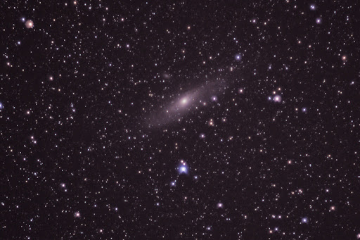

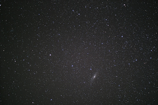

A few hour later, DSS churned its magic:
(again 133 light frames, just under 9 minutes total exposure time)
IMAGE: http://lh5.ggpht.com/_FqTNmgNQHz8/TKwqU8YVkAI/AAAAAAAAK84/4OXUX8GvEA8/M31%2010-5-10%20v2.jpg
Crop of M31:
IMAGE: http://lh5.ggpht.com/_FqTNmgNQHz8/TKwqVNVkfWI/AAAAAAAAK88/u4KmSNkS9i8/M31%2010-5-10%20v2%20-%20Version%202.jpg
This is straight outta DSS - I applied 15% color saturation there to bring some color back, imported into Apple Aperture 3, no PP except slight edge sharpen.
While crop not as crisp as atomsmurf's (his T2i sensor diff?), this has me excited for how much detail I can see.

Whats causes the haloes around all your stars ? I noticed this on astrosmurfs images also . If you can get rid of the haloes then you might be able to see how much true data you have . Haloes do make objects project bigger than they really are even when stacking many images .

Its does the same thing if i go out and use my 50mm f/1.4. I would think its an over overexposure of the brightes stars.

I tend to agree slight overexposure seems the cause.
If I'm not too sleepy tonight I'll re-shoot, using same settings but at 3 sec exposure instead of 4 sec exposure, that will be 25% less. I'll take more images to keep total exposure time around 9 minutes. This should also give more crisp image for crop as well, less drift.

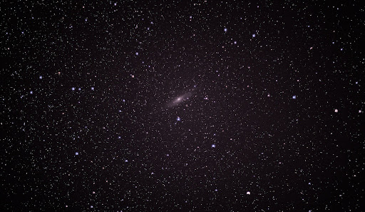

I wanted to re-take M31 with less exposure time to solve the halo issue, 10/5 was 4 sec, my choices were 3.2 or 2.5 sec on the T1i, I choose 2.5 sec
New images taken Oct 7th 4:30am-ish
Single un-processed image with EXIF data
IMAGE: http://lh5.ggpht.com/_FqTNmgNQHz8/TLIig7xH63I/AAAAAAAALAI/jpH2OoqjPf4/_MG_4562.jpg
Here are 367 light frames 2.5 sec exposure each (15min 57sec total exposure), ISO800, 50mm prime @ f1.4; + 54 dark frames + 30 Bias frames. DSS processed, output into Apple Aperture 3.
Compared to 10/5 images appears slightly crisper and not overexposed.
IMAGE: http://lh4.ggpht.com/_FqTNmgNQHz8/TLIfXvRTFcI/AAAAAAAAK_c/0S9rZWtEFD8/M31%2010-7-10%20v3.jpg
Crop of M31 is kinda cool, can I barely make out actual arm swirls?
IMAGE: http://lh3.ggpht.com/_FqTNmgNQHz8/TLIfYMyUa5I/AAAAAAAAK_g/0KNvWMZmP6Q/M31%2010-7-10%20v3%20-%20Version%202.jpg

M33 pinwheel galaxy.
You're doing real well with this technique.
