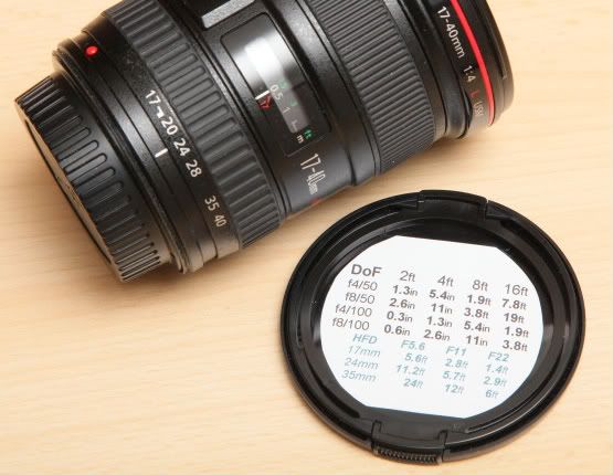

This is how I do it. Quite simple really, with these few numbers written inside the lens cap of my 17-40L lens. Data from www.dofmaster.com (external link) and note that these relate to full frame; crop format is different.
HFD..........f5.6.....​..f11......f22
17mm......5.6ft.....2.​8ft....1.4ft
24mm.....11.2ft.....5.​7ft....2.9ft
35mm......24ft.......1​2ft......6ft
The reality of hyperfocal distance focusing is that it only really applies to wide angles and landscape photography. And because the real world use of depth of field is not nearly so exact as the numbers might lead you to believe, it is easily possible to estimate the inbetween settings.
One of the key things to know about HFD focusing is that the near point of the hyperfocal range is always exactly half the HFD, ie HFD 10ft, everything sharp from 5ft to infinity.
This is how I do it in practise - landscape with distant mountains and a nice rock formation in the foreground. Frame it up at 24mm, and visually estimate that the nearest rock I want sharp is 6ft away. I therefore know that the hyperfocal distance I need is double that at 12ft, and I will normally use AF (centre point, focus-recompose) to focus on something which I visually estimate is twice as far away as that nearest point. This is very easy to do, and completely avoids the need to refer to any distance scales on the lens, which are often not much help. Then inside my lenscap, 12ft corresponds pretty closely to f/5.6. Job done :)
Just one more thing. HFD focusing can be quite controversial, and one objection is that by definition what it does is put infinity right at the extreme limit of acceptable sharpness. If those distant snow capped mountains are maybe the most important thing in the shot, then you need to make sure they are very sharp indeed, rather than just sharp enough. There are various ways of addressing that, but one of the simplest is just to use a higher f/number than the one suggested, in the case above, set f/8 instead of f/5.6.
Here is the inside of the lens cap in question, same as the one on my 24-105L, which has also got a few regular depth of field reminders on there. I hope the numbers are readable, because when you notice that there is a lot of halving and doubling and squaring going on, it's easy to work out what the DoF is for 25mm and 200mm with a bit of mental arithmetic.

The key is to learn the approximate values for different apertures for selected focal lengths. The idea of jotting down notes to keep in your bag or even - like shown in a post above - in the lens cap is a good one. You can easily estimate the distances involved and that would be plenty accurate.

The key point about what I posted above, is that you don't need to be able to estimate distances too acurately, or depend on the markings on the lens focusing scale which are usually pretty unhelpful.
As mentioned above with HFD setting, whatever the subject in the foreground is that you want sharp, then just focus on something that is twice as far away. Use centre-point AF and focus-recompose technique (which I use for pretty much everything anyway). That's your HFD set.
The only bit of estimating you need to do is then take a stab at how far away that focus point is. Maybe the focusing scale will, with luck, have a number that you can read off, but if it's fairly close, then it's quite easy to guess accurately enough. If it's further away, then you don't have to be so accurate as DoF increases with distance. And if in doubt, use one f/number higher and you'll cover it anyway.

Thanks for the reply - just what I was looking for.
