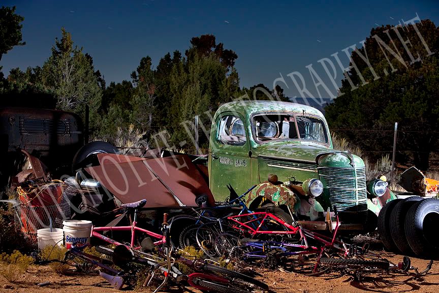

Jan 21, 2011 11:23 |  #42
NotASpeckOfCereal wrote in post #11612794 (external link)
can you describe your approach to these shots please? - exposure, iso, lens etc
Really it is just a series of experiments. In this shot, The aperture is at f5.6 iso 400. The higher the iso, the more digital noise you get, also if you go too low of an iso the longer the shutter has to stay open, and the more digital noise you get.
IMAGE: http://i519.photobucket.com/albums/u354/RG-Photography/Sample-4.jpg
You have to work with some sort of ambient light to make the shots worth a damn. In this case, a rising full moon off tot he left, and two Canon flashes in my hand off to the right. Just like a western gun-slinger I fired the flashes a few times in different locations. Usually I wait till I'm ready to close the shutter, then I fire away or use an LED light.
Also it helps to have a stop watch on your cell phone to use as a timer of sorts so you can keep track of exposure time from one shot to the next . It almost always takes a few attempts to get the subject lit up to where I like it. Always shoot it RAW too. You can always adjust color temps and even light levels etc in post processing.
It takes a fair amount of patience and experimenting to get to what effects you want. At least it does for me. Also don't be afraid to work in levels in photoshop if needs be. And try different flash lights etc. LEDS will give you a truer bright white while halogen bulbs will give you a yellow cast, which works great for making old broken headlights look like they are on.

Automotive ­ Photography
185 posts
Location: Southern California
Jan 21, 2011 11:25 |  #43
Sorry for the giant watermark. Im using this photo in a book Im working on and don't want it out on the web before it goes to print.
