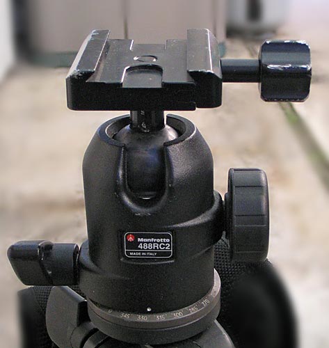

Ii just popped to my mind that I can use my old 488 RC2 with the RRS.
I just need a new QR base plate and the L-plate.
So that saved me some $ instead of getting a new ball head. I think the 488 RC2 uses the 1/4" male tread. So I will need the reducer from 3/8 to 1/4
I have gotten so used to the 488 that I prefer to use it.
Yeah the Loctite made for thread locking is the one to use. I have some at work. Loctite 248 if you use the red you need to heat it up for removal and that is a pain

You don't need the reducer. If you remove the entire RC2 clamp and plate from the 488 you will be left with a 3/8" male thread on the top of the post. You can then screw any clamp with a 3/8" female threaded hole in the center onto the post. It's as simple as that.
Here's my somewhat beat-up 488 with a Kirk knob clamp on it:
IMAGE: http://johnwright.smugmug.com/Photography/My-Gear-1/IMG8115web/211779443_cAfnQ-L.jpg
There are also RRS lever clamps that will fit.

RRS used to have a table of which of their clamps to get for the various heads out there. Like John, I adapted my 488 to an A-S clamp; in my case the RRS B2 LR II (which is what I'd suggest if you're using the RRS L plate).
