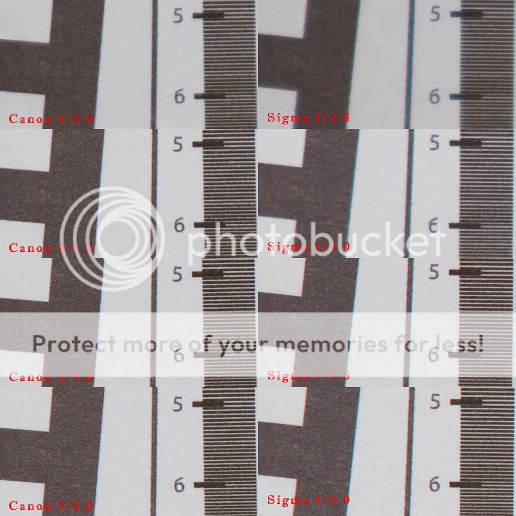

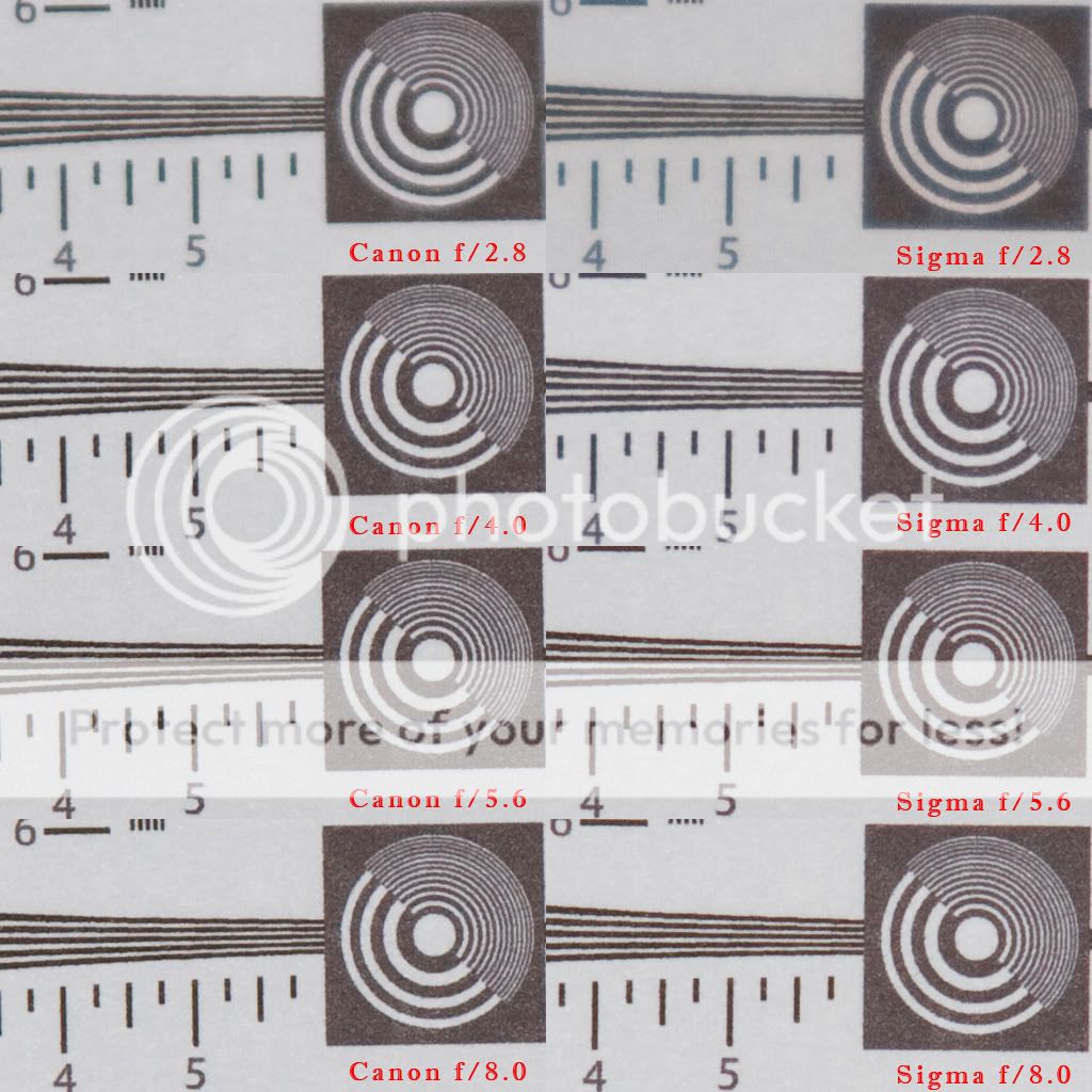

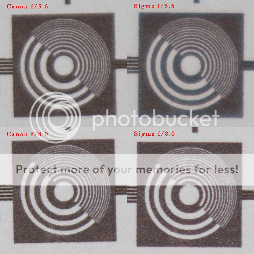

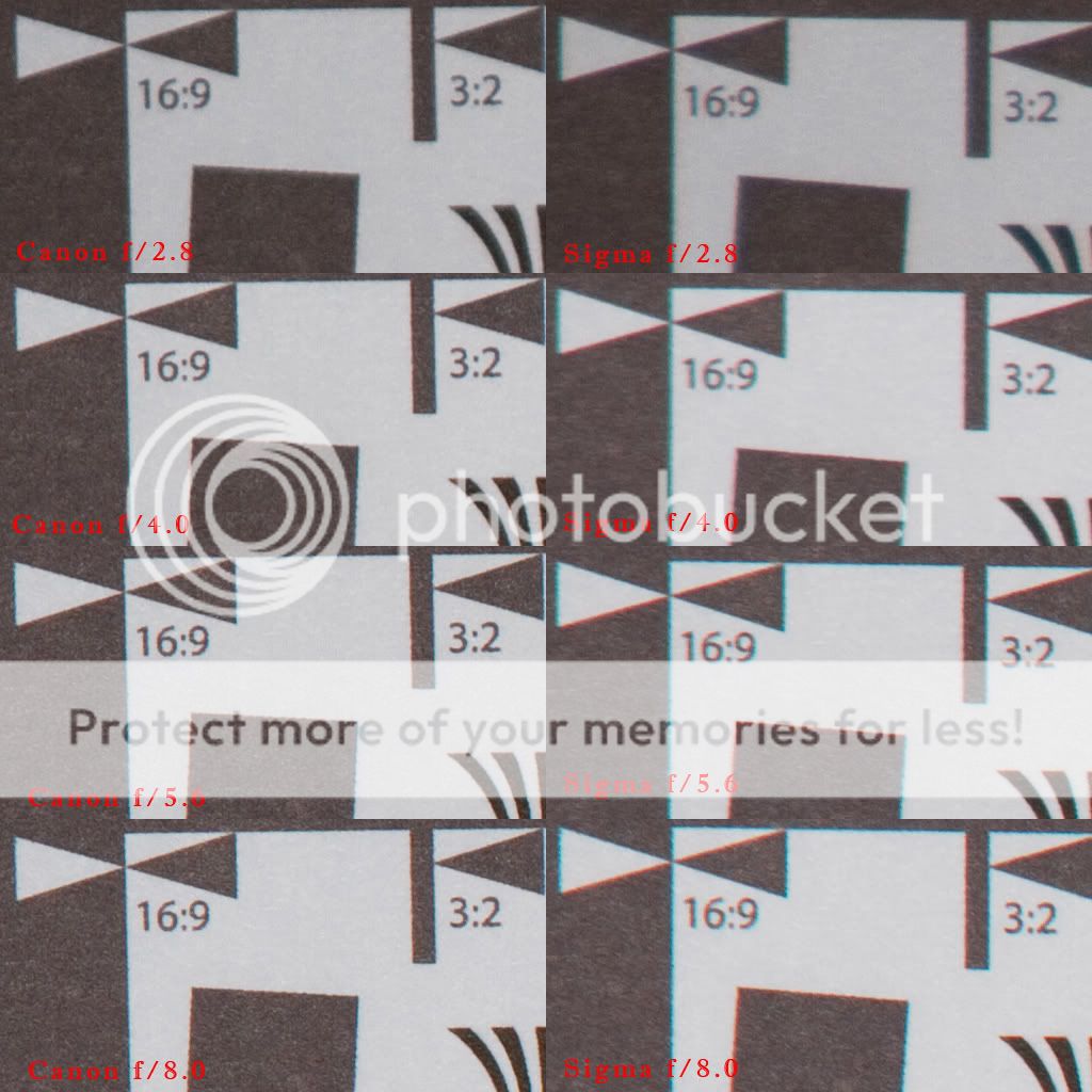

Last night I wanted to test how the Canon 70-200 f2.8 IS II took a 2x Kenko DGX Pro 300 TC so I printed out a chart (This was just printed from my regular printer so the quality isn't very good, I'll try to obtain a higher quality chart in the future) and set up a tripod and did some tests. Then I was like "Since I have all this set up, why not test my Sigma 70-200 f2.8 HSM II as well?" Well, I was a little surprised with the tests.
The tests I ended up doing were
200mm at f2.8, f4.0, f5.6, f8.0
400mm at f5.6, f8.0
All tests were done at ISO 100 and Shutter Speed of 1/250sec , IS was turned off on the Canon lens. To keep the same exposure in all photos, 580EXII was used.
f2.8 1/64 power
f4.0 1/32 power
f5.6 1/16 power
f8.0 1/8 power
All tests were done in Live View, manually focused via computer tether, silent shoot mode 2 (all these to ensure AF accuracy and minimize vibrations).
The tripod setup was Manfrotto 190CX3 with a Manfrotto 488RC2 head.
Camera was the Canon 7D.
All these tests were manually focused at 10x magnification.
All of the following are 100% crops.
200mm Tests
200mm CENTER
IMAGE: http://i765.photobucket.com/albums/xx291/themadmanazn/Canon%2070200%20f28%20IS%20II%20v%20Sigma%2070200%20f28%20HSM%20II/100Cropsat200mmCENTER.jpg
200mm MIDDLE
IMAGE: http://i765.photobucket.com/albums/xx291/themadmanazn/Canon%2070200%20f28%20IS%20II%20v%20Sigma%2070200%20f28%20HSM%20II/100Cropsat200mmMIDDLE.jpg
200mm EDGE: NOTE: I am not sure my setup was perfectly perpendicular (lens to chart) so some softness might just be due to the setup being out of focus due to the plane of focus not being perfectly parallel to the chart!
IMAGE: http://i765.photobucket.com/albums/xx291/themadmanazn/Canon%2070200%20f28%20IS%20II%20v%20Sigma%2070200%20f28%20HSM%20II/100Cropsat200mmEDGE.jpg

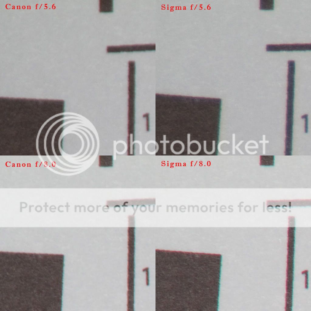

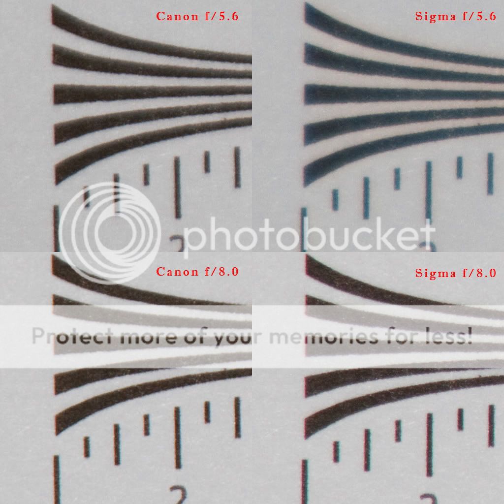

400mm Tests
400mm CENTER
IMAGE: http://i765.photobucket.com/albums/xx291/themadmanazn/Canon%2070200%20f28%20IS%20II%20v%20Sigma%2070200%20f28%20HSM%20II/100Cropsat400mmCENTER.jpg
400mm MIDDLE
IMAGE: http://i765.photobucket.com/albums/xx291/themadmanazn/Canon%2070200%20f28%20IS%20II%20v%20Sigma%2070200%20f28%20HSM%20II/100Cropsat400mmMIDDLE.jpg
400mm EDGE NOTE: I am not sure my setup was perfectly perpendicular (lens to chart) so some softness might just be due to the setup being out of focus due to the plane of focus not being perfectly parallel to the chart!
IMAGE: http://i765.photobucket.com/albums/xx291/themadmanazn/Canon%2070200%20f28%20IS%20II%20v%20Sigma%2070200%20f28%20HSM%20II/100Cropsat400mmEDGE.jpg

To me the Sigma perform VERY well and I was very surprised. I have always liked the lens and I was at time perplex when it would give super sharp results some times and only so so sharp results over times. I have come to determine the Sigma HSM in the 70-200 f2.8 HSM II is not as good as the Canon USM in the 70-200 f2.8 IS II.

^ From the test photos the Canon has the edge but the Sigma is not far behind.

The real difference is at the edges and you would prob see greater delta on a FF camera.
The Canon L lenses are very good at Chromatic.
But you get what you pay for.
Is it significant and worth the cost - you be the judge.
Still -
I bet a Sigma 400 mm will beat a Canon 200 with a 2 x convertor - any convertor - any format ! !

As El_Pic said, you get what you pay for. If you can spend more money, the Canon is totally worthy IMHO as it gets better detail wide open, where I think people need this lens for (otherwise, why not to get the F4?)
Those "dreamy" haziness thing of the Sigma wide open is something always made me think about them, tough...

I don't know why you are surprised. I can see a clear difference between the Canon and the Sigma in all of the wide open shots, especially in the middle and at the edge. The 2X TC shot at the edge is strikingly different with the Sigma contrast just wiped out.
