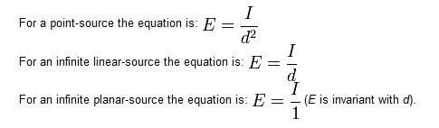

Dec 08, 2010 10:31 |  #26
BestVisuals wrote in post #11414317 (external link)
Point source of light doesn't matter. The source-to-subject distance exposure works for point sources, bounced sources (umbrellas) or any kind of modified light source.
What makes light diminish is whether it's coherent or non-coherent light ("regular" light vs. laser). Not even using a lens over a coherent light removes the diminishing effect.
Au contraire. The point nature of the source does matter. A true point source radiates outward in a sphere if increasing diameter, the number of photons emitted from the source is fixed, so as the diameter increases the number of photos per unit area are decreasing, resulting in the Inverse Square relationship.
For an infinitely long linear source (think fluoresent tube infinitely long), the relationship is Inverse Linear (rather than Inverse Square_.
For an infinitely large 2D planar source, the falloff is much less than inverse square, linear in its relationship.
For real world planes (i.e. softboxes) this is true when the subject is within 2x longest dimension of the softbox. At greater distances the softbox begins to behave like a virtual point because its size is diminshing with distance.
From Wikipedia
IMAGE: http://i69.photobucket.com/albums/i63/wiltonw/Principles/Inversesquareexception.jpg
