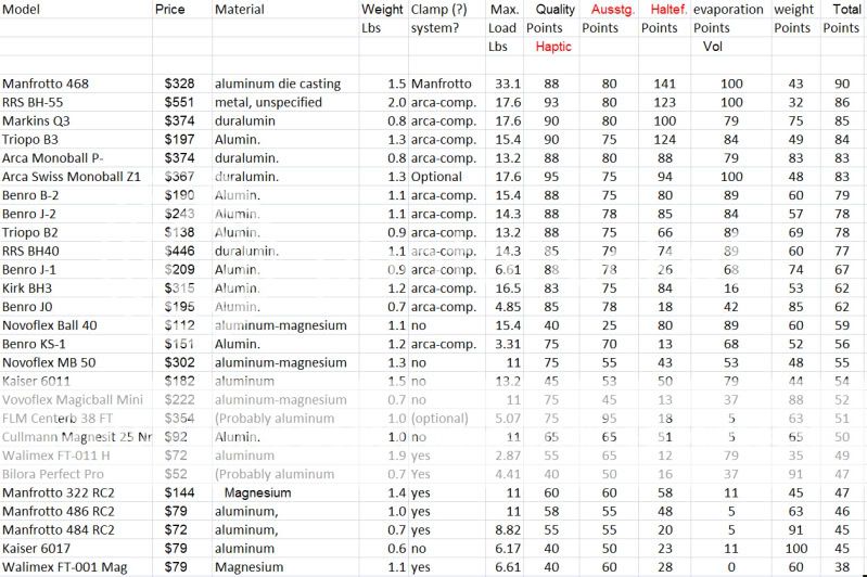

MCAsan, no doubt it's a great ballhead, All of the choices in the OP (with the exception of Benro are top choices and no matter which way I go I'm hoping it lasts a very long time. The issue is balancing price and weight into the equation.
Peter, awesome feedback and information, thanks. Exactly the type I was hoping to get. So, if I hear you correctly you're thinking the Q3 is perfect based on my current equipment, but maybe a little light duty in the future should I end up with a 100-400 or other monster. Even with a tripod mount? BTW, want to sell me one of your Q3's?
I converted the link Peter supplied to english so I could better understand it and figured maybe some of you would benefit too. Here's what it says (not 100%, but pretty close). Sorry, but it's a bit long.

A central thrust of our report was the search for a head that is holding at high skills and good equipment due to its light weight and compact design for outdoor use - that is the easy photo trip - is suitable. We found the Markins Q3 and the Arca Monoball P0, which meet these criteria. The buyer will be asked, however, properly to checkout, plus quick release plate for over 300 € required.
Also excellent in its holding ability and at similar price level of the Arca Swiss Z1 single ball is located. Because of its aspheric ball or even an idea the buttery soft run of the locking button, it acts on us a little idea of noble than the Markins. One acquires the Arca Monoball in a version with quick-change system, it weighs about 670 grams, this weight, we think the photo trip, at least for borderline then when every gram counts. In the studio he used to beat but barely. The same is true for the more serious RRS BH-55, the production technology is without question on the excellent level of Monoball Z1, a little better holding abilities but is also more expensive.
Of the maximum holding capacity, and the pleasant feel of the main set screw provides the Manfrotto 468 MG the greatest comfort of the test field RC4, but also on the road you have to live with a fairly high weight. Overall, however, it offers the best performance throughout the test area and is priced comparatively attractive.
The Kirk BH3 is flawless, aside from little things like the rather low damping of vibrations and the usual in this price range but not present in the integration of the friction screw locking lever. The buyer will receive for 240 € a head including quick release plate, which is also recommended for high weight requirements - like the whole Kirk also act a little cold.
With many special features are highlights of the FLM Center Ball Head 38 FT. Those who travel with more equipment and is looking for a light refined head with many features, can be happy with it. A little training time is necessary because of the many set screws for a fleet operation on site, however.
The Novoflex Magic Ball is 50 MB not least thanks to its unusual design and its high production qualities to become a stalwart among ambitious photographers. Even professionals such as Michael Martin you see in the desert with his head to operate successfully. However, the buyer is certain compromises in user-friendliness by the lack of such a panoramic plane or restricted Neigfähigkeiten.
IMAGE: http://i315.photobucket.com/albums/ll479/j-blake/Misc/BallheadComparison.jpg

something important to me, not seemingly covered by table....will the ballhead hold a L bracket from RRS, Kirk or others? Can't imagine going to the field without a L bracket on the body to switch between landscape and portrait orientations when using lenses that do not have rings with feet.
IMHO, we need compatible systems...ballheads, quickrelease clamps, L brackets and plates for lens rings that all work seamlessly. Some brands can offer the entire scope, others only part of the puzzle. Think twice of using brands whose parts can not be part of a complete package.

MCAsan, I agree with you. My original list came from a site which analyzed makes and compatibility and I chose those which were compatible with the RRS L bracket since that is what I'm interested in matching.
peter, I will take a look at the Markins Q10, but as weight is very important if it's heavy that will weigh in to my decision quite a bit. I'll keep you posted on what I find.

I'm not sure of the accuracy of this table, but according to it there are several manufacturers of compatible QR clamps with the RRS system.
http://www.afximages.c​om/stuff/arca-plates-xref.html (external link)

They guy who created the table I linked in post 12 said the same thing when I questioned him on why the Arca Swiss and RRS are not completely interchangable.
